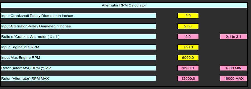

Does anyone know of a place to get a 2" alt. pulley for a 95 gt? According to the formula from paperformance.com, i need a 2" pulley on my alternator for it to have the correct shaft speed. ------------------------------------------------------------------------------------------------------------------------------------------------------------------------------------------------------------------------------------------------------------------

the alternator shaft speed should be no more than 16,000 RPM.
An alternator needs 1800-2000 at idle to make power and will make maximum output at 6000 rpm, and will start to fail at 16,000 RPM.
Here is what i get with my current set up:
this is with a 2" alt. pulley:
