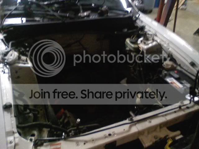

Well seems like i Det. and hurt the rings. the pressure is lifting the heads and blowing coolent all over. New upgrades going in.
old setup
stock pi heads
Mph blower cams
D1sc 13 psi
when 11.20@125mph and 456 rwhp auto car 2800 stall
New setup
Stage 2 heads all plug holes timecerted
D1sc (not sure neather 3.2 16psi or 2.9 21psi
3800 stall
Looking for a decent 550-600rwhp and a 10.60-10.80 car
ill keep ya all updated as i get more done.
New rings will be here tomorrow (total seals) then to the machine shop to file fit the rings and motor will go back in. :eek:ccasion14: :eek:ccasion14:

Things are moving slow. My heads came back today. But i putting some Total seal rings in this motor. So have to drop the short block off this week at the shop. I will get a few more pic Later this week

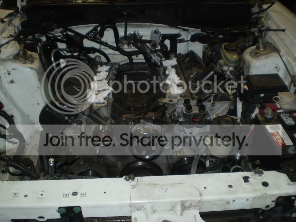

Updates. Motor is Being reringed as we speak. I picked up some P&P Heads. and bought a 2.9 RR pulley. Today I hit a jackpot. Found a Full Full system with 4000 miles on it. Its the Twin pump able to handle 900 hp for $500 WOOP WOOP.
This car will be a sub 10.50 2v

Update
My 1000hp Fuel system showed up last week. And my Stage 2 Meth Kit will be there this week 20PSI + Meth = mean sob
