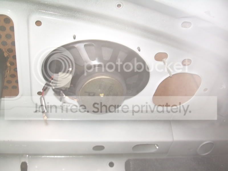

When I'm in m,y trunk looking up at my speakers there are four screws coming down towards me. There is no way to unscrew them, or take them out from underneath... Pics later today.

I'll get pictures up when I get home on Tuesday. Four nuts are completely unapparent. There are four screws coming down, however.

Finally got some pics. As you can see, they are not set up how you described...

I need to do the same thing...they come out from the top...remove the rear seat, side panels & the rear shelf..be careful not to break anything, tabs etc...
They are the same size as the front speakers..6x8's / 5x7's
I ran a speaker wire temporarily under the center console, then under the carpet on the side of the drive shaft hump worked it into the center of the rear seat area & up to the speakers...when I pull the rear out I'll run the wires along the sides.
