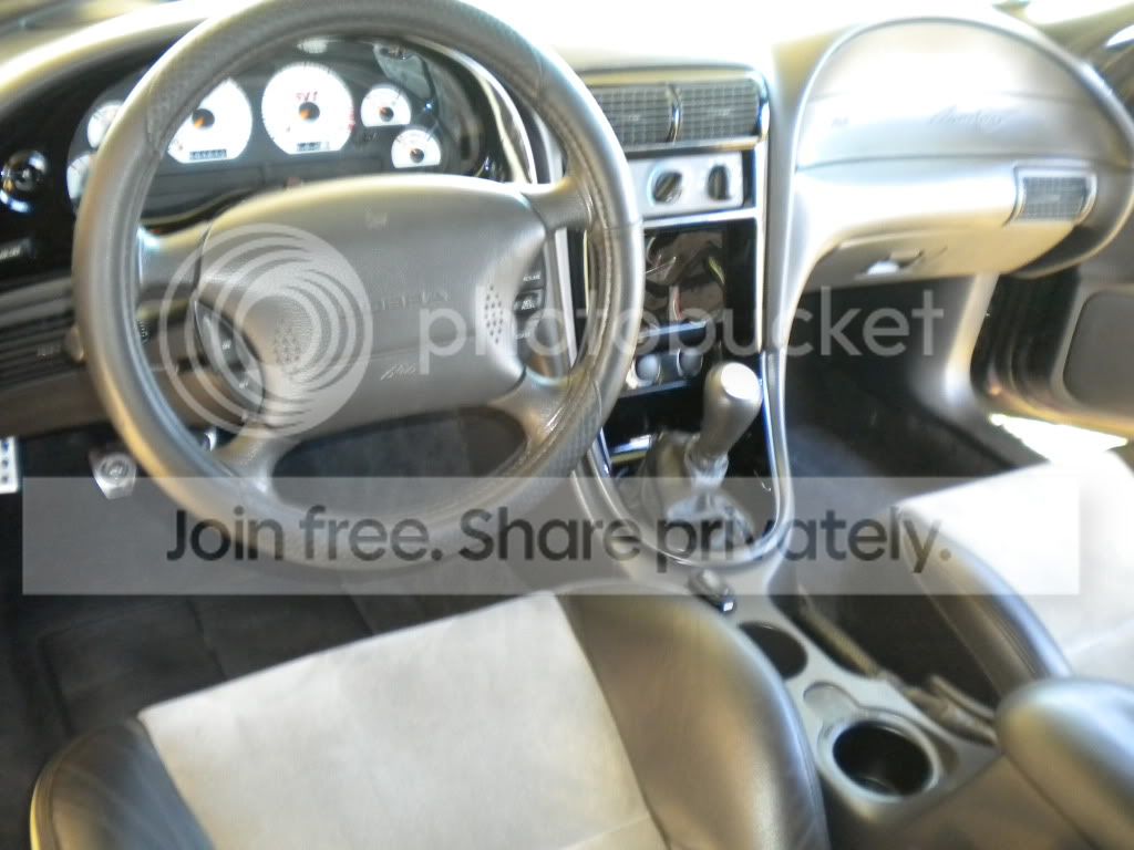

Well, I finally swapped in my 03 interior and am almost done with it. I've had the 03 seats for a couple of years already along with a 03 center console that I painted to match the stock black interior. My main reason for doing the swap is that my stock dash had a crack on the top front pass side from the air bag deploying when a deer attempted to commit suicide (he failed).
The only things left to install are the stereo which I can't make up my mind on if I want to install the 6 disc changer I have or go with an in-dash screen. Also left to do is install the ignition key black cover, headlight knob, and floor mats which are all in my storage still.
I hated doing this swap and it took longer then I expected, mainly because I really didn't want to do it.

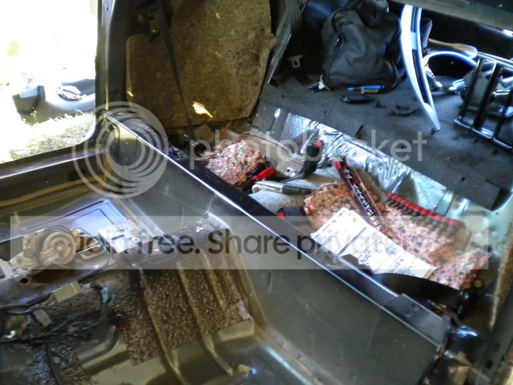

Thanks for the link Javi, I needed one more bullitt pedal since I ruined one of them when installing. The other one you can kind of see in the trunk area in one of the pics. I replaced the entire dash but there is a difference in the fuse panel location metal bracket. I drilled out the spot welds in my original one and removed the bracket and vice versa on the new one. I didn't want to have anything hanging or zip tied so thats the reason for it. I'll post a pic of that later on today. The dash isn't that bad to remove, just time consuming, theres 11 bolts holding it to the firewall and all are easily accesible. The dash harness must be removed with the dash bc if you don't then you will be hating life and will probably just burn the car to the ground from frustration. All the connections can be unclipped at the driver and passenger side kick panel areas.

^^^Color change to match my 03 seats, double din stereo, and no clock. I've always liked the charcoal interior better and a plus is that it looks "newer" with the healiner and lack of clock pod. I had an 03 center console in the car with the black interior already that I painted to match so the cup holder thing I had already done a few years back.
