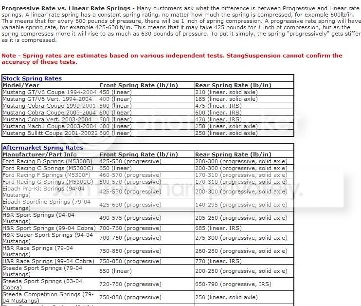

Looking at the chart I would say the rear H&R sport springs would reduce peoples chances of rubbing due to the high starting spring rate @275.
