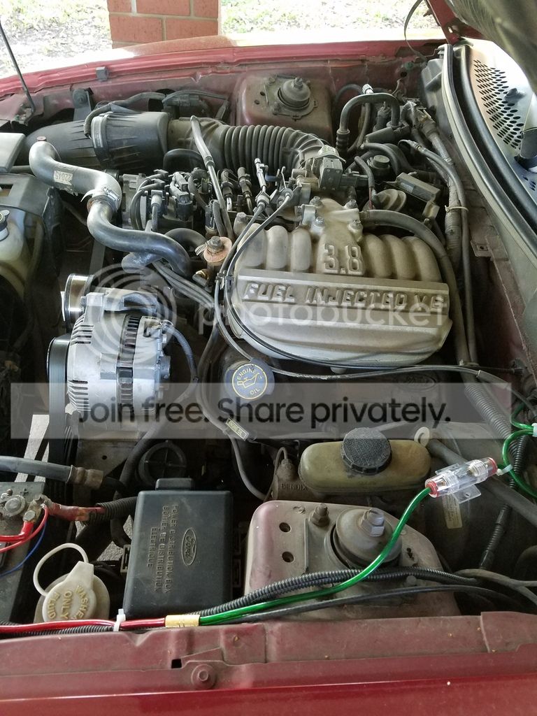

Engine *Top end is stock*
Stock Ford Essex v6 engine block
Stock Heads
Stock intake manifold
Stock Cam

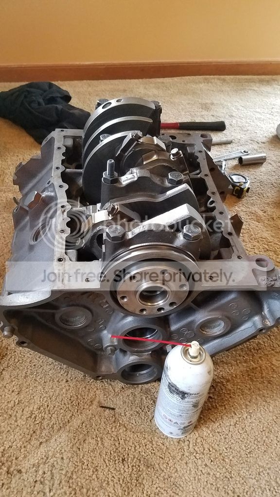

4.2 Ford F-150 Crank
Ebay 4.2L Piston Heads {CPW 4.2L V6 OHV TRITON Cu.256}
3.8 1999-2004 Piston Rods
***Important note; 1994-1998 Piston rods will not join and bind correctly with 4.2 Heads. Must be the "new edge" 1999-2004 rods to connect to 4.2 heads due to simple weight
distribution and sizes.***

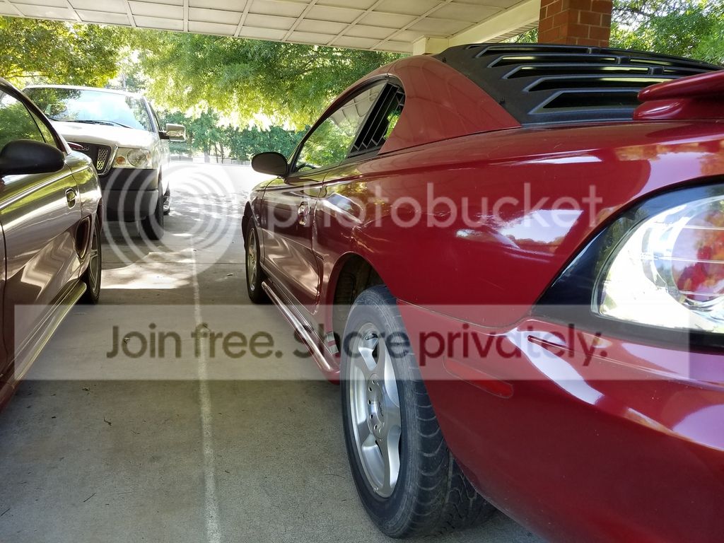

Exterior
Repainted to "Electric Current Red"
Spoiler Added and Painted
Cobra Front Bumper
Blue Fog Lights
Aftermarket European tail lights.
Rims are a mystery to me. Feel free to find what they are.
Quarter Window louvers
Rear window louver

After paint job and Louvers on:
Good oi 3.8, going to miss you buddy. Bad bearings :(

Engine with 4.2 Crank and Heads:
Engine with oil pan, crank, timing cover, and etc on:
