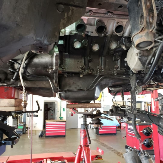

Wonder if its a simple bolt on? a quick search found this article that looks like Classic Design Concepts use to offer the kit, but unfortunately don't anymore. Also I how was the install of that K-member? i've got the same UPR kit ready to install after i paint the bay on my 99
Simple. Ok assemble the k member do not tighten anything down just hand tight the nuts and bolts.
Lift option--
Lift car up
Place exhaust stand or trans jack under engine with a block of wood so u don't crush anything
Relieve pressure by jack the engine up just enough that the rubber on the mounts move.
Remive engine mount bolts
Remove chassis ground
Remove the 6 bolts holding the k member up u will help 90lbs total
Make sure to drop the a arms down from the ball joint
Also remove the 2 bolts from the rack and pinion slide it forward and jmuse bunji cords to keep it away
Drop the k member kick it away lol
Up with the tubular k memeber and visa versa I have mad videos but on here u can't post them id k y

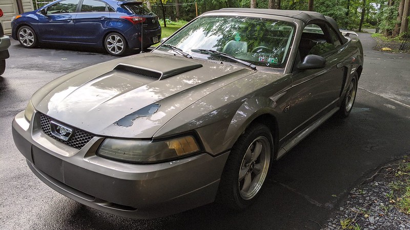

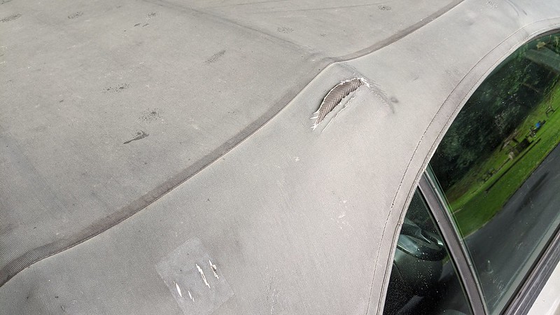

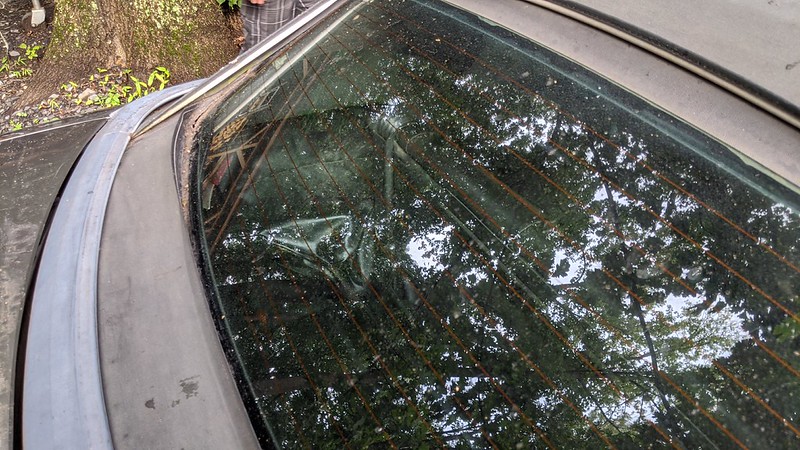

Took a look at convertible today... it was rough. The pictures and description on the post made it seem pretty decent. If they were only asking a grand for it, it would be a decent deal. But man oh man was it rough.
  • Both strut towers were starting to rust
  • convertible top didn't work at all and had a bunch of rips
  • rear glass was starting to separate from the top
  • inside smelled musty - definitely had been leaking
  • Both latches to release the top were flaking
  • Paint missing on hood
  • Front fender looked like bacon
  • Front & rear bumpers didn't fit right, had gaps
  • Some rust starting on the rear quarter
  • Mileage on cluster would come and go (common issue my 99 does this)
  • Clutch pedal vibrated like crazy
It's a shame because the car ran and shifted perfectly, had brand new inspection stickers, good tires and the Mach 1000 worked and sound far better than my Mach 460. But for $2,800 its not a deal for me. Maybe if it were around a grand or less I would take it on. I might low ball the guy and see what he says only because i want that Mach 1000 for myself lol
See thats not worth it

Yeah, I would've passed on it too. Maybe 1k max and probably less the longer it sits.

How many miles were on the car. I must not be as picky because a new top and a quality interior detail fixes half the issues. The rust spots didnt look horrible maybe come in at 2k or around that? Guess it's all in what you want the car for.
