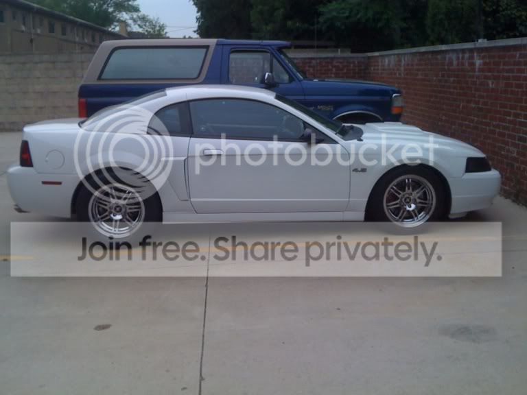

sooo you're going for this look?

lol okay. Reason why you're using a bigger tire instead of a taller tire and a smaller wheel?

I'll have to set it on the ground again as im undergoing a trans swap. i should of snapped some but i wasnt thinking. it fills the wheel wells nice
