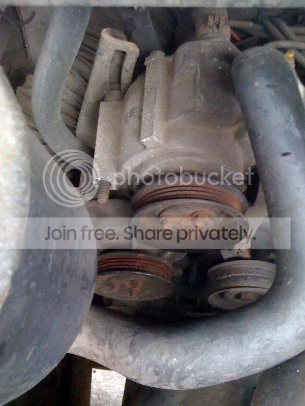

Well besides the idler pulley neither of the other two pulleys turn?? The smog pulley turns half way only, and the a/c compressor pulley doesnt turn it all. Does that mean i need a new a/c compressor and smog pump? The smog pulley, a/c pulley, idler pulley, and alt pulley run off the same belt, when i put a belt on them the alt pulley(alt pulley run off two belts) still spun but the belt didnt turn at all because the other pulley wont turn.

Ok this is the one up top that spins a little bit. They both look like smog pumps to me but i cant picture two smog pumps????
This the one that dont spin at all.
I dont know what this but both of the two pulley i'll pulled off all hook up to this.

Damn. You got me there dude. I'm stumped. I know 5.0 liter Mustangs, but apparently I suck at vans. LOL

After doing some research to my eyes starting bleeding, I decide to take a trip to Advanced come to find out the 351w in my E350 has two smogs pumps.
