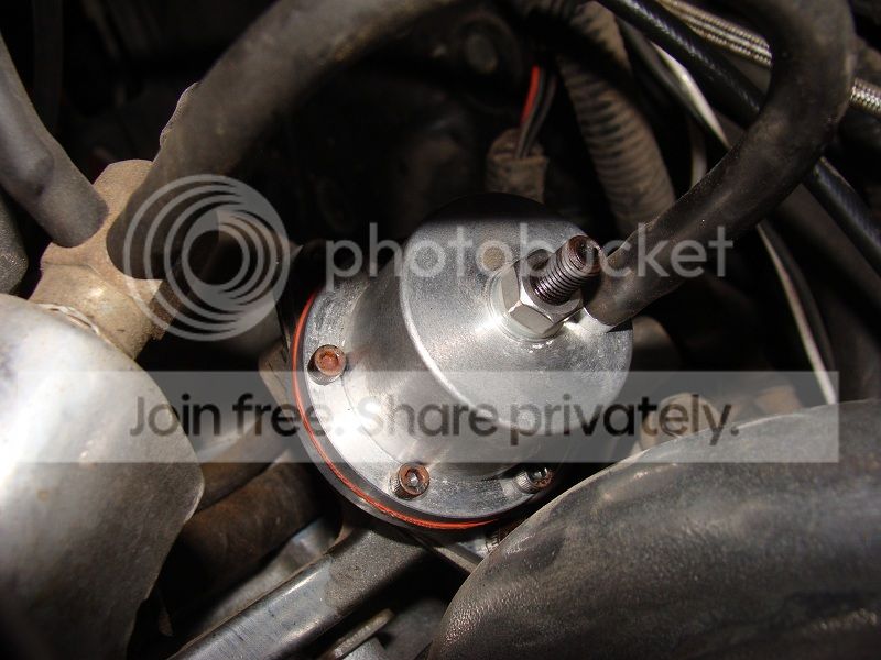

A few parts installed this weekend ...
Cobra MC with MM install kit. Went in pretty easy, I hope to gain some brake feel with this. My GT MC was like stepping into dogshit, then the brakes would lock up. I'm thinking it was due to the bigger brakes.
Then a Kirban FPR, adjusted to 41psi.
Bought some side skirts from a dude parting out a 97. Get those on for some asthetics, and order up some new # decals. Dyno day is in 5 weeks, March 9th I go on the rollers for CMC legality (260hp/310tq max), safety, and scales (3150 lbs max with driver)

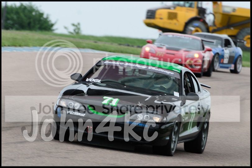

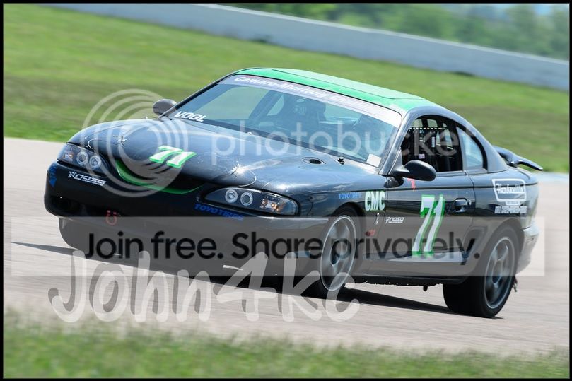

Couple of pics from HPT (Heartland Park Topka), it was a sweet track. Something new, but man was it hard on tires. Took 2 4th place finishes and a DQ, currently ranked 4th in points in the region. I was DQ'd for screwing up a start. Essentialy we were doing a 2 flag start, group infront of us was to go on the 1st green, then we were to line up for a standing start and take the second green. I saw the 1st green flag and just took off with the 1st group. Rookie move, lol. oops.
Next weekend we'll be at Pueblo doing some test and tune. Got a few things to try out with the car. I'm having issues with understeer and I think it may be due to incorrectly setting up my PHB. Hallett is a no-go. Wish I could but just don't have funds or time to make it work.

you seem leaps and bounds in front of that dump truck in the last pic! Nice work! :-D
