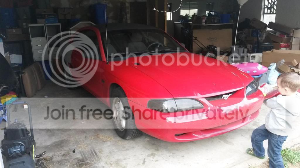

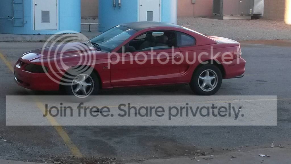

Guys, meet my new girl. Her name Tammy Lynn, she's 21, has a pretty good body, but she's kind of a butter face. I'm pretty sure she's been passed around a lot, but she's from out of state so none of my friends will know for sure.
But I like her, she's a cheap date, picked up for 1g. Sure she's a little bit embarrassing to be seen with, and you're mom would definitely not approve... but when you're inside Tammy Lynn none of that matters...
This is going to be a junk yard and swap meet build. Nothing about this car will be more than thrown together. No shows for this pig.
Motor: Stock explorer motor with upgraded springs and cam. Unsure of the cam, just whatever I find, cheap and used... just like Tammy.
Tranny: Actually shifts great and is noise free, so I'll try finding a decent short throw shifter to keep her that way.
Rearend: I'm going to go to the junk yard and find some 3:73's out of an explorer. yeah, that's the direction this build is going.
Paint: I'll be doing all the prep work.. then I'll either take it to Maaco or say the hell with it and try spraying it myself.
Interior: Her cockpit is a little dirty and slightly loose... like it's missing bolts and random pieces and has annoying rattles. I'm going to pull the interior, power wash it, put it back together with all the bolts and nuts... and replace anything that's suppose to be there and isn't, or that's broke. JUNK YARD POWA! clean and tight feeling, that's how I like my cockpits.

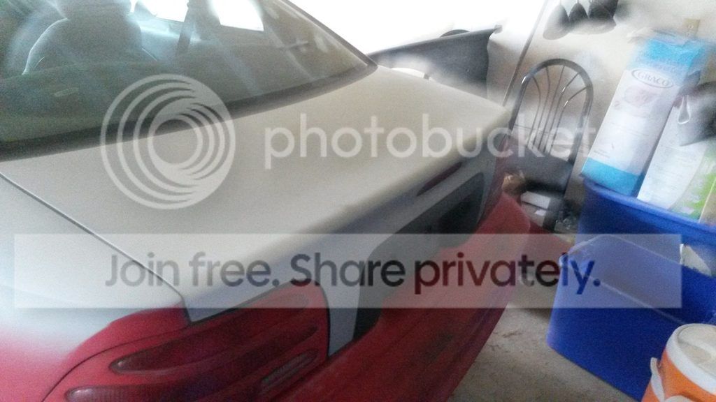

I've been going back and fourth on rather to build the engine or do the body work first. Well yesterday I was bored, so I took some red spray paint I had sitting around and sprayed on a light guide coat. I noticed the color was pretty close, so I laid down a wet coat just to see what it would look like. The color matched better than expect. I was going to color sand and then spray on another coat, but I ran out of time after wet sanding. I think I'm going to lay down a few coats, wet sand, then buff it out... and leave it until summer.
That way, I can focus on building the motor and getting some 3:73 gears put it.
I didn't get a picture of the paint before I color sanded, because intended on finishing it yesterday. I'll finish it over thanksgiving break.
