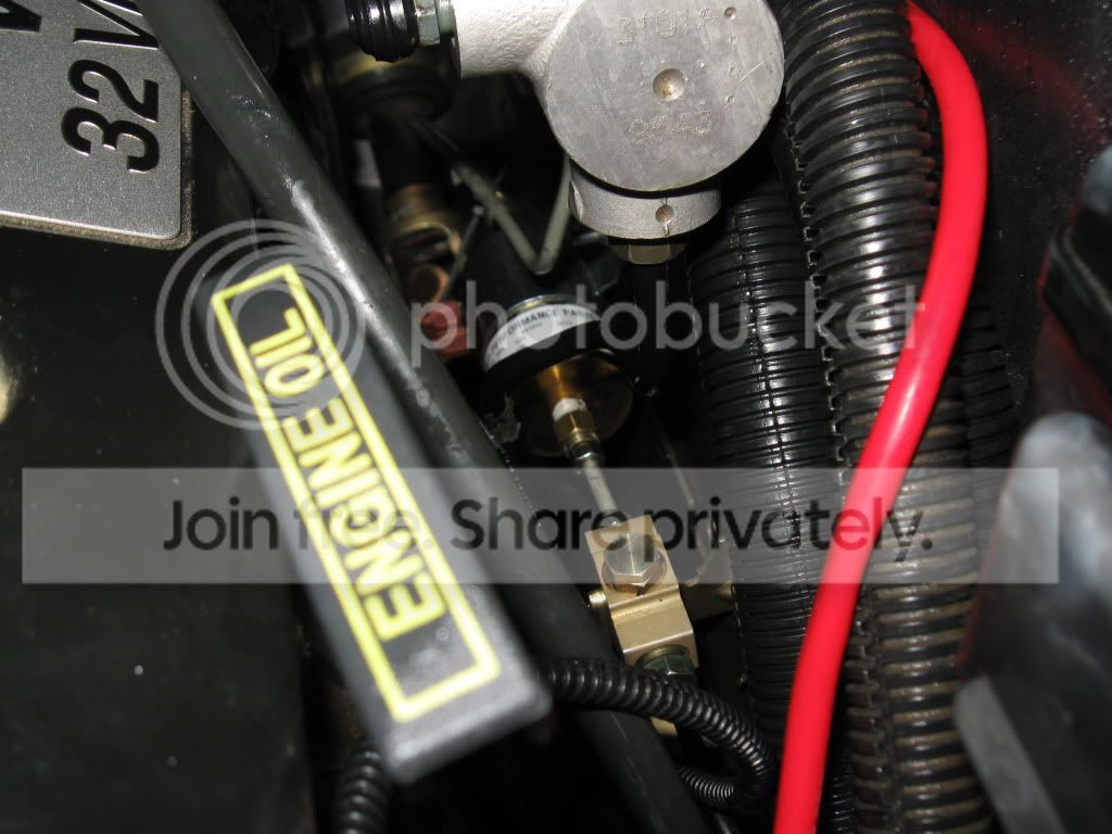

Well, I was able to get a 2 day span to do some minor work on my car before I have to get it into storage (brother's car is at body shop getting hail damage fixed). Anyways, I'm going to install some of the simple things (or so I thought) before taking it to work to use a hoist to cut off the old exhaust/put the new rear springs in. I'm working on installing the line lock kit (PITA, huge one) which has involved lots of swearing already, no room to work with on a 4v! 2nd, I'm finishing up my stereo install and I'm in the process of running the power wires for the amp/subwoofer as well, trying to make it as "clean" as possible. Finally, I'm installing my cut stock springs (before I get the "OH NOEZ CUT SPRINGS?!?1/1/!!!11!" guys, read the SVTperformance thread on cutting linear rate springs). I swapped the H&R race springs out already(they are the what was installed in these pics) for the 1/2 coil cut stock springs and it sits a little higher since these race springs are a mild drop from factory. So I have to get my cut off wheel from work tomorrow to take it to a full coil :). Also, I tinted the taillights a few weekends ago, so that's why I have a pic of that in there as well, will include more pics tomorrow after I'm done swearing!

^^I'm going to stalk that out. 1/2 coil literally did NOTHING to ride height. I have my stereo wiring in, just have to put in the amp/subwoofer, working on wiring the line lock, still swearing at that lol. I'll have new pics up by the days end though, I hope it drops it some...

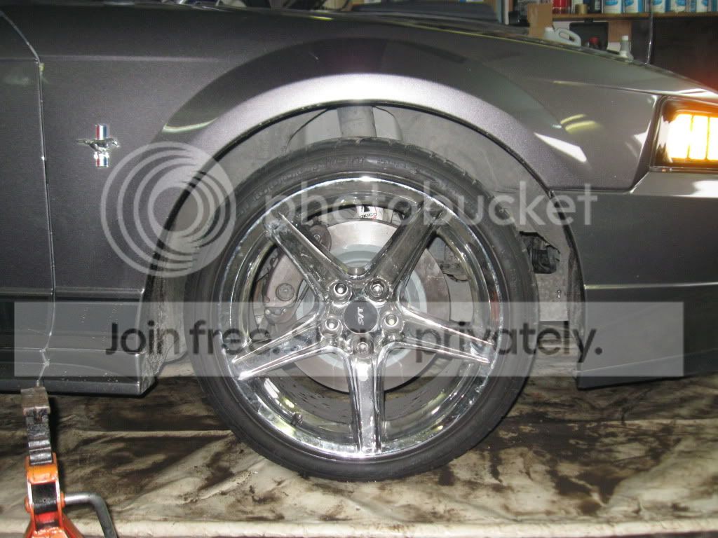

Here are the pics, drop doesn't look like much but it is lol. I have undersized tires (almost an inch in diameter shorter than they should be) so it seems big, but I rolled my 275/35s from the rear to the front, 2 finger gap which is what I wanted! All isos in, and the line lock is in and works, love it! My arm looks like I fought with a cat though. Springs will settle a little and I'm getting new tires soon to get the sizing proper, current fronts are 255/35.

lol they are in right, these tires are 25" tall vs. 26" which they should be, so there is an inch missing. I can't fit my jack under the car anymore so now I have to work on it on the hoists at work :/. I never put my stab links back in yet, I wash rushed to get everything finished, but I will take the springs out again and double check, it takes like 5 mins.
EDIT: @mygreen. It's really easy, jack up car, take off wheels, put jack underneath spring perch, unbolt strut,unbolt stab end links, lower jack slowly, pry spring out. I have done this numerous times now so I'm getting good at it.
