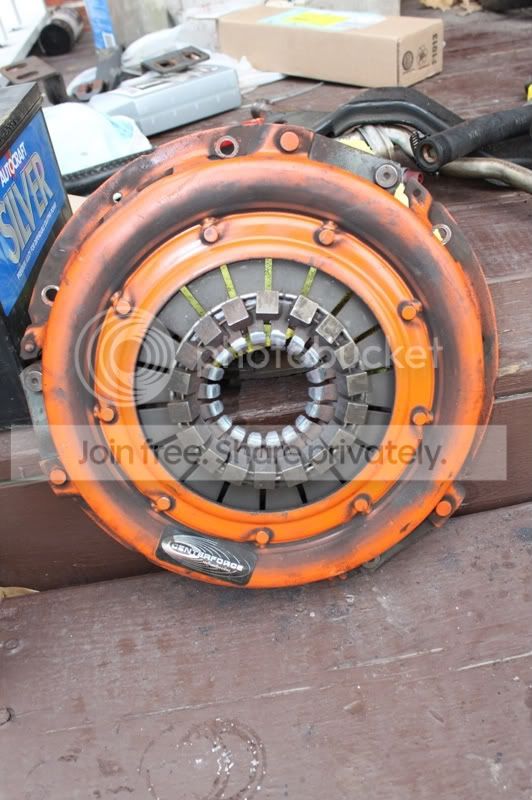

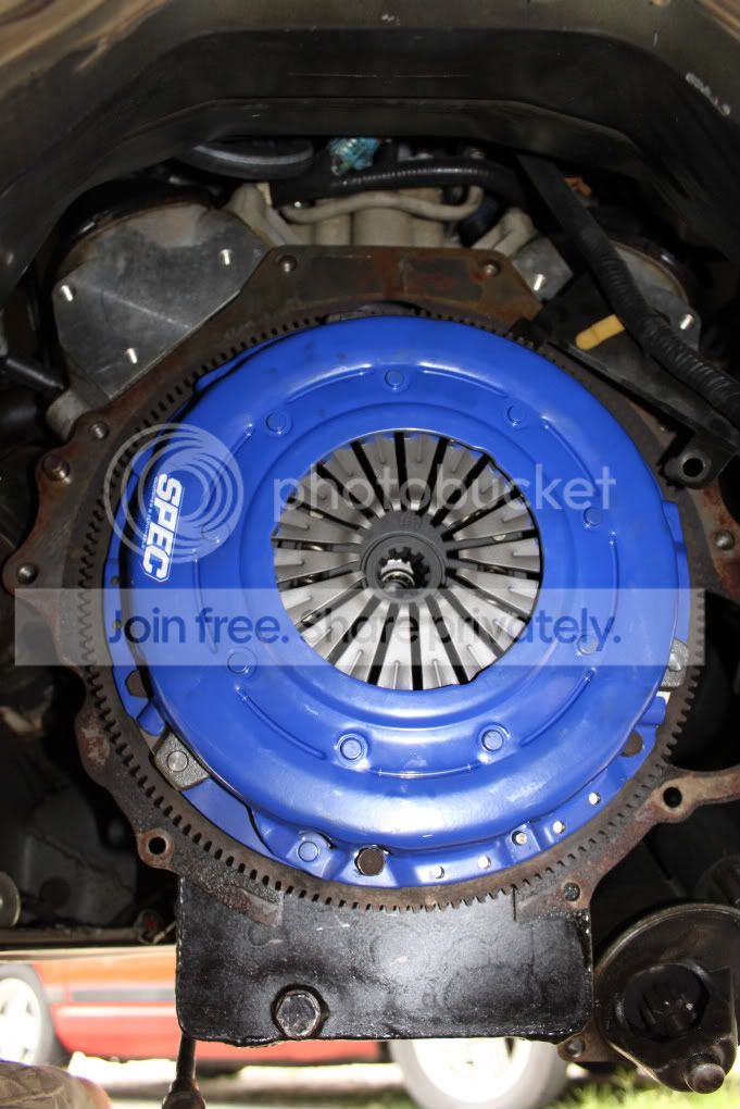

Well here we are. Finally.. My car was down for about 2 weeks due to a throwout bearing the decided to literally implode on the intput sleeve. It trashed everything! So here I am ready for re-assembly. What I have to install is -Centerforce flywheel (was already installed but had re-surfaced) - Brand new Ford racing Aluminum drive shaft -Spec Stage 2+ clutch kit. -Brand new OEM clutch fork.

The old Clutch and new one

The car is back on the road! It shifts soooo much smoother than before, and no clutch chatter either!
