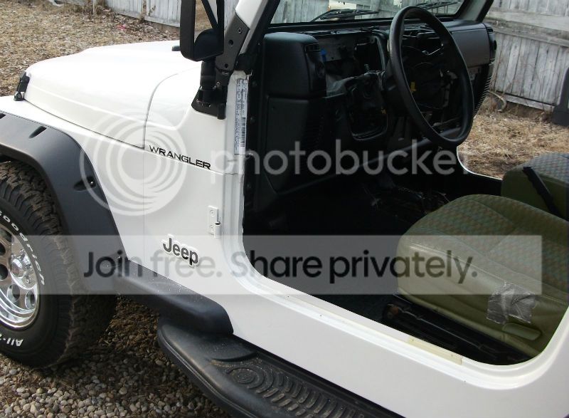

any wrangler fans? my 98 tj

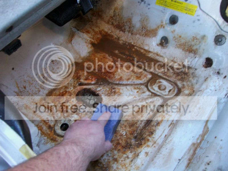

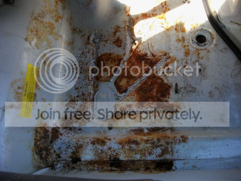

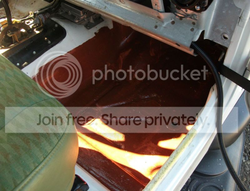

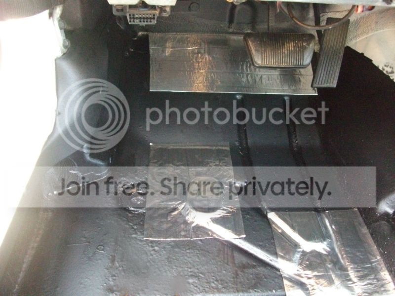

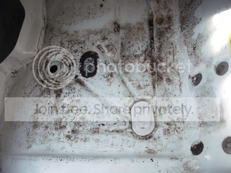

no i'm repairing the rusty floors and sound deadening/carpeting with waterproof bedrug kit
white vinager/water plus a scothbrite pad and coarse sanding sponge helps rid the rust a tad.
mixed water and vinager in the lysol bottle lol.
turning the rust black is a good sign its working

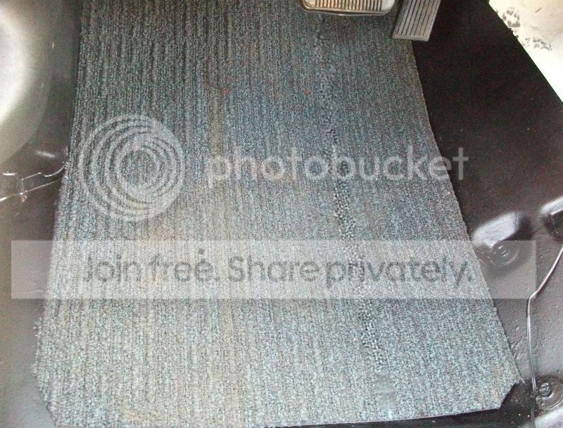

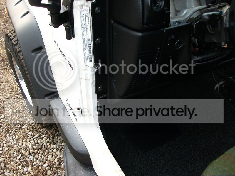

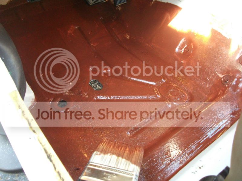

after 3 coats

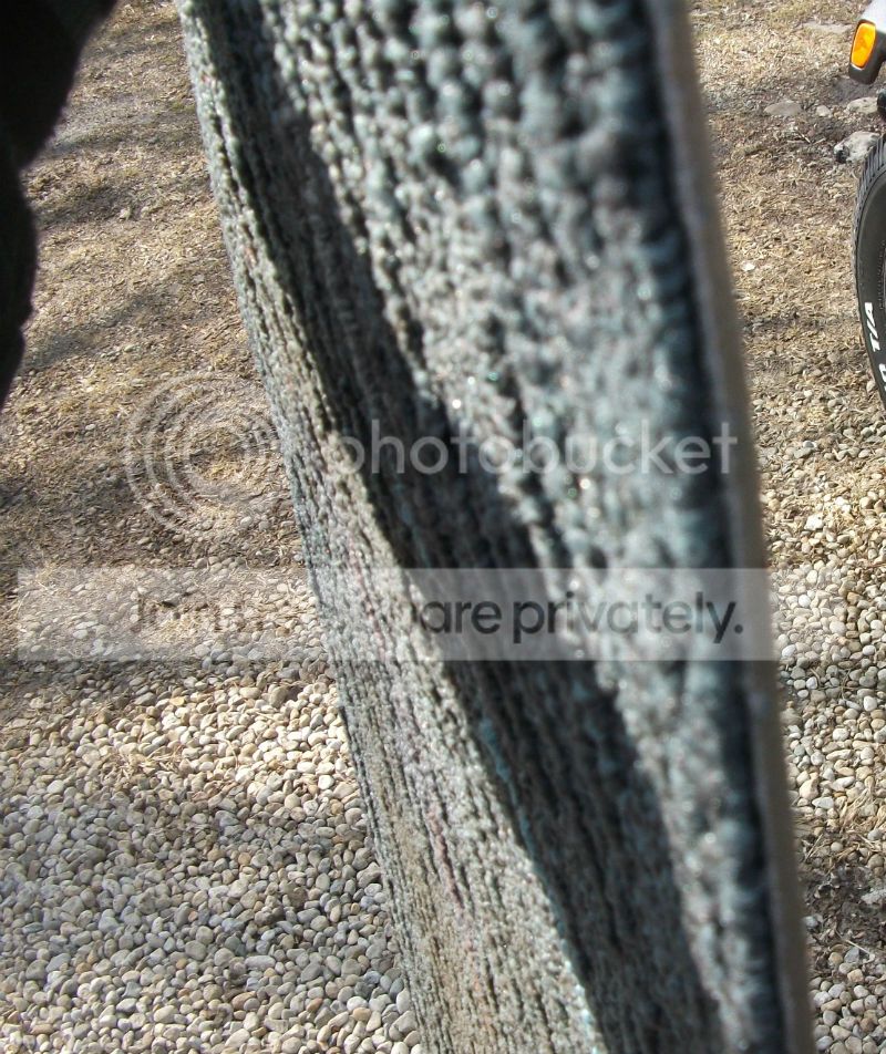

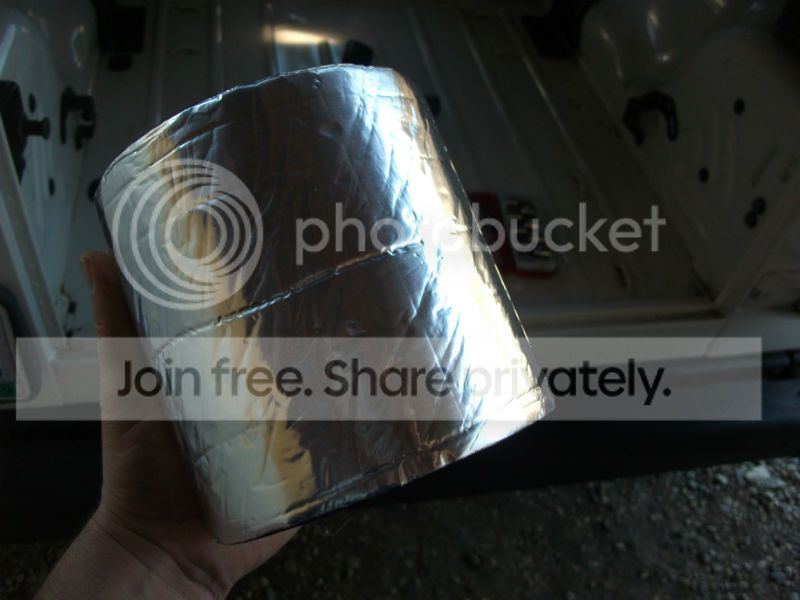

what you guys call peal and seal i call sound deadener :p

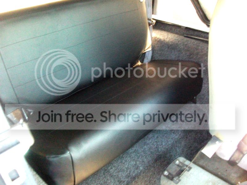

i kinda cut up the old carpet mat for a little more sound deadening as i plan on doing a lightweight audio setup

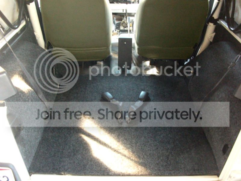

new carpet

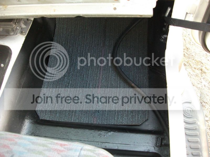

seat in
this is just the rear carpet section done. still gotta do the front and center

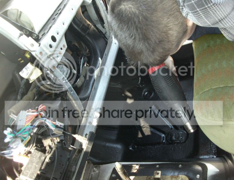

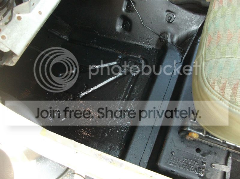

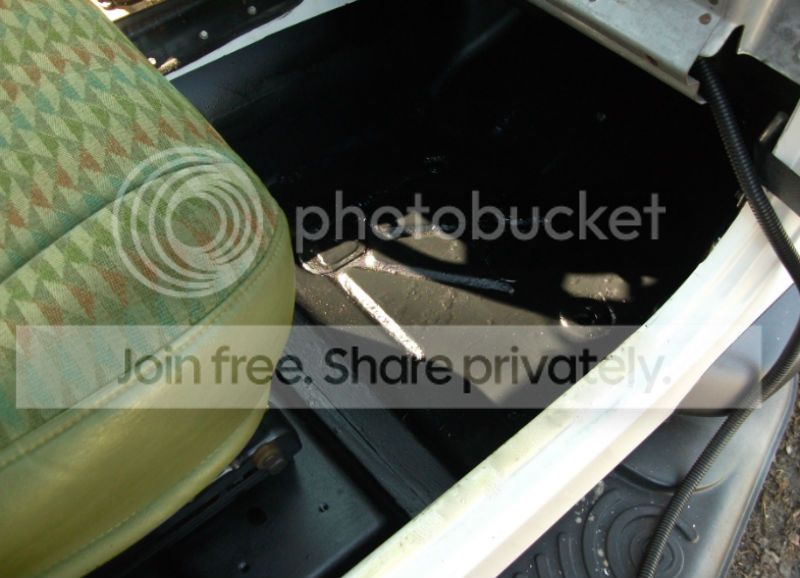

me and my son got the floors cover in flat black this morning. a tad chilly out but not too bad.
some heat gun action to help the cause to dry lol

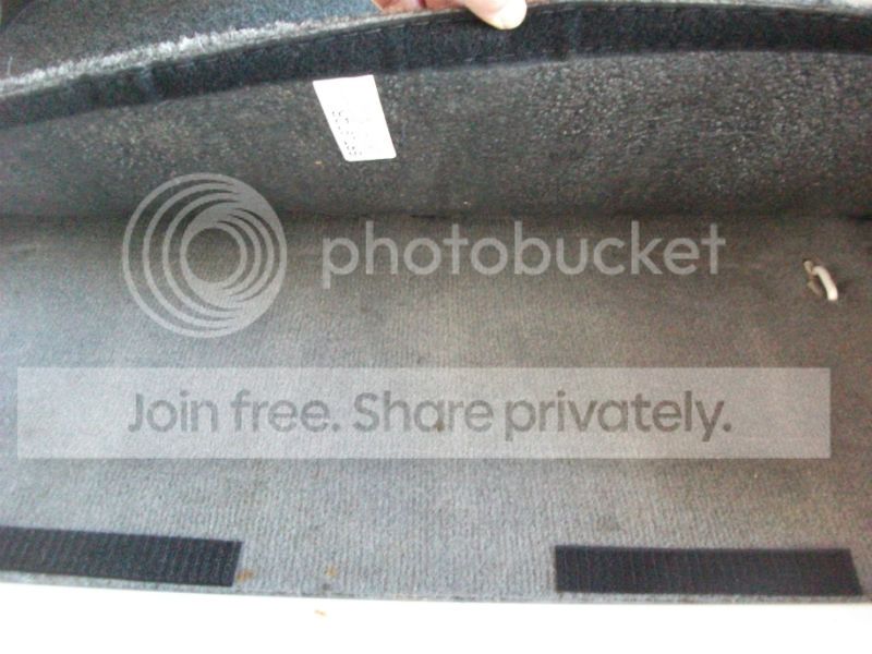

a little more peal and seal for sound deadening along with some super dense carpet tiles i cut up to help with sound deadening. finished all of the carpet and started installing the dash. new soft half doors from quadretec i never posted.

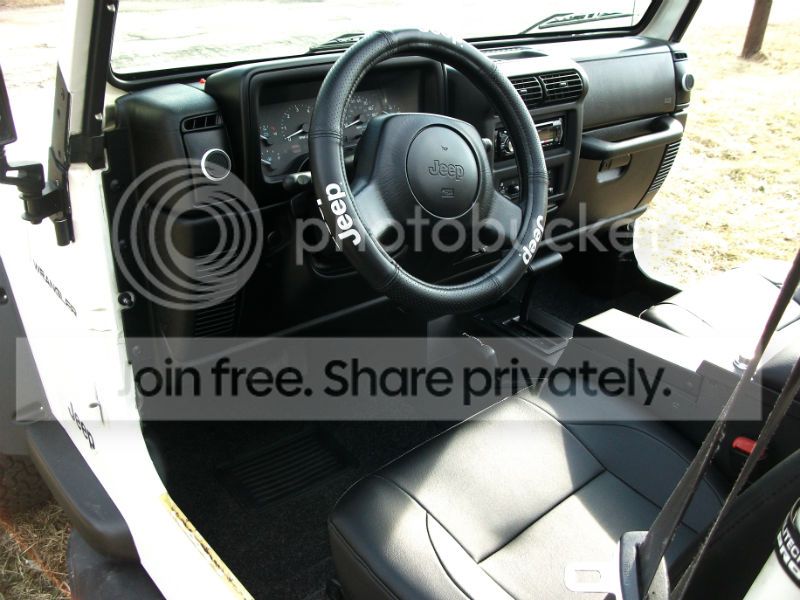

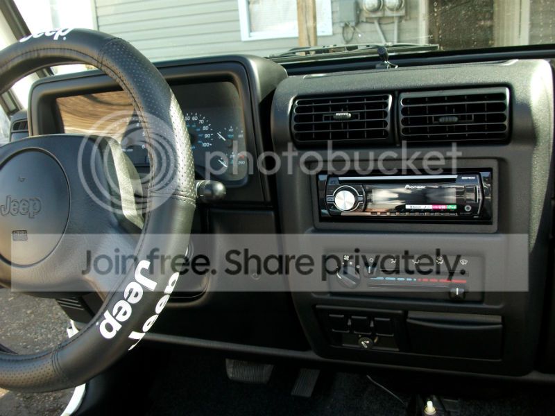

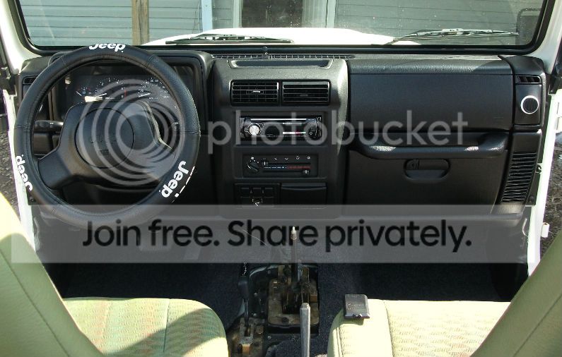

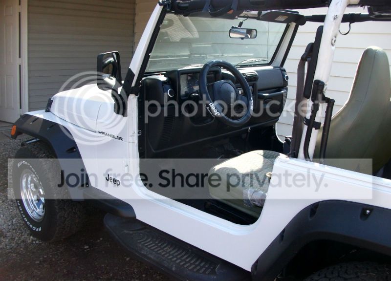

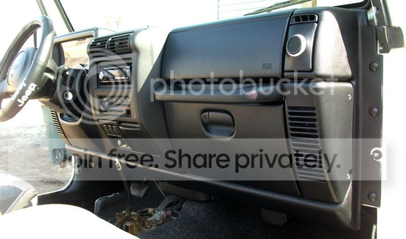

dash is finally complete and installed. i redid the whole steering wheel but threw this cver on it as i know the dye will prolly come off over time from grabbing it so much.

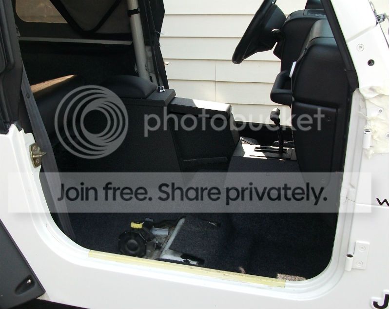

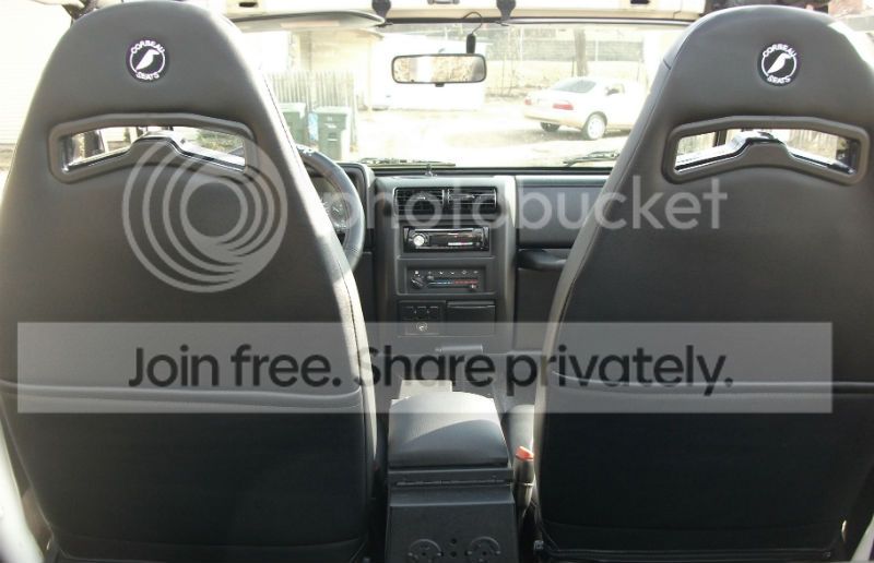

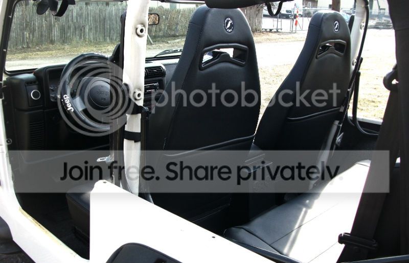

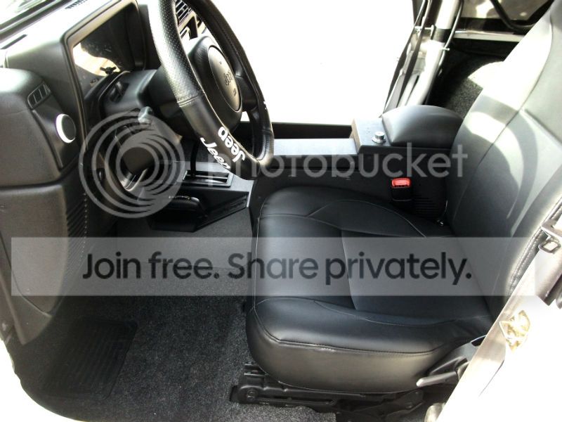

console is in

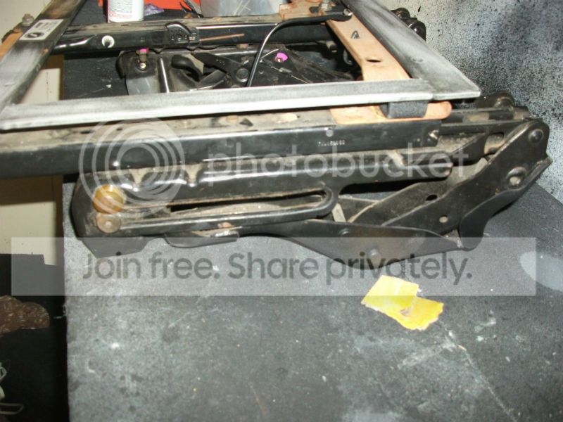

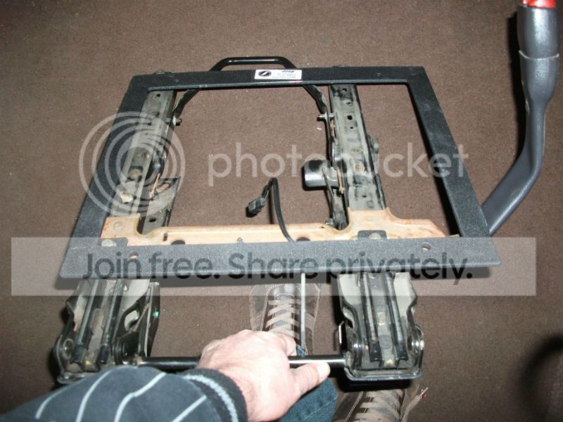

took the old ugly seats out and cleaned up and painted the seat brackets
got one seat in

interior is done. i kinda feel like you guys don't like me anymore lol. dam nobody replies to my shit at ALL :undecided:
i'll post some pics here &there anyway for a few jeep fans anyway ha!

The interior looks great! Much better than it was before.
How did you get almost the exact same texture on the little tweeter pods as thats on the rest of the dash?
yaaaaaay...a reply :blob1: haha...j/k.
i used that cheap textured vinyl on it after i glassed them then shot the same color that i did the dash with just to get it all uniform.
