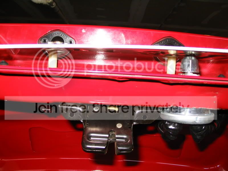

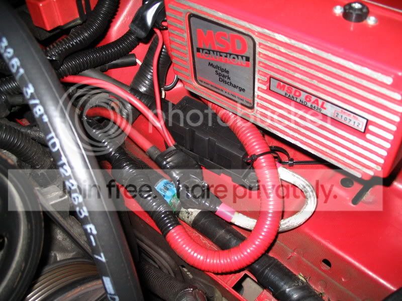

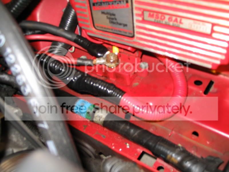

CanaryGT
May 22, 2006
3,689
Phoenix
Here you go.
