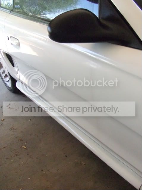

this stuff wont rub out .....happedned after it rained once .....it wont rub out the wax i have isnt doing anything at all

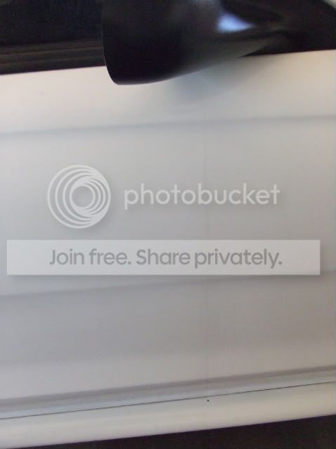

this one has finger prints that wont rub out .......
anyone have this issue or any ideas .......makes me wanna paint my mirrors

Wax will only make it hard to come off as wax leaves a layer (hence why they call it a layer of wax :D)
Get some rubbing compound and it will come right out.
If I remember correctly there should be a little foam type of material behind your mirror, it could be holding dirt and letting it run down when it gets wet.

had the same problem on my white ProbeGT... rubbing compound or polish is your friend

use a mildly abbrasive conditioner (miguires offers 2 or 3 different types) then a polish, then a wax.
waxes are used to simply seal the clear coat from external eliments (tar, acid rain, dirt, whatever) so you are actually SEALING that black stuff under the wax next to your paint... kinda like putting some strange man in bed with your old lady and then putting a blanket over them. it masks the problem, may reduce the appearance a little, but the problem is still there...
use the abrassive compound to remove the wax you've put on it and to litterally "scrape" the contaminats off the paint. On show cars with 3/4/5/9/10/++ coats of clear coat they occationally wet sand the clear coat to pull the swirl marks out. The abrassive compound is doing the same thing, but on a softer and gentler level...
after this you have to use a polish (obviously you dont "have" to do anything, but its what i am suggesting.) the polish will fill the minor (think on the molecular level) gashes/tarnishes that the abrassive compound makes (and damage that occurs naturally.)
Finally use a wax after buffing off the polish. this will seal teh paint and polish from external eliments.
honestly, thats all i can suggest. if it doesnt work, i have no idea how to get it out. 3M makes a buffing compound body shops use to pull out orange peel, swirl marks, keying, and other things. that would be my final suggestion. its basically a heavy abrassive compound (like i already suggested) but its MEAN... lol. its not as bad as wet sanding, but its not as gentle as miguires or mothers abrassive buffing compounds.

You won't need any mean stuff or wetsanding! Maybe try claybarring it, never tried that on my probe, but I imagine that would do the job too.

clay bars tend to do an amazing job on things that you cant even see and GIGANTIC chucks. lol. i personally doubt a clay bar will get the job done. it may, but i doubt it will.

All you need is Klasse All-In-One and it will come right off with little effort.
on Sale now
http://www.autogeek.net/klasalpolsea.html
Will also remove water spots off windows/paint, clean your rims, kitchen counter, stove, fridge, sinks, toilet tank, ect, ect. Your car will look whiter (a blinding white) then wax right after wards. It strips off any old wax/sealant/oxidation as well. I get those streaks out all the time with it, actually I use Jeff Werkstat Prime STRONG which is an updated version of KAIO.
Well worth the $$ man and a great combo for crystal white is KAIO/Nattys Blue.
EDIT: A cheaper alternative to KAIO is Duagloss #501 marine polish.
http://www.autogeek.net/duragloss-marine-rv-polish--501.html
You can get this at Napa or have them order it for you.
