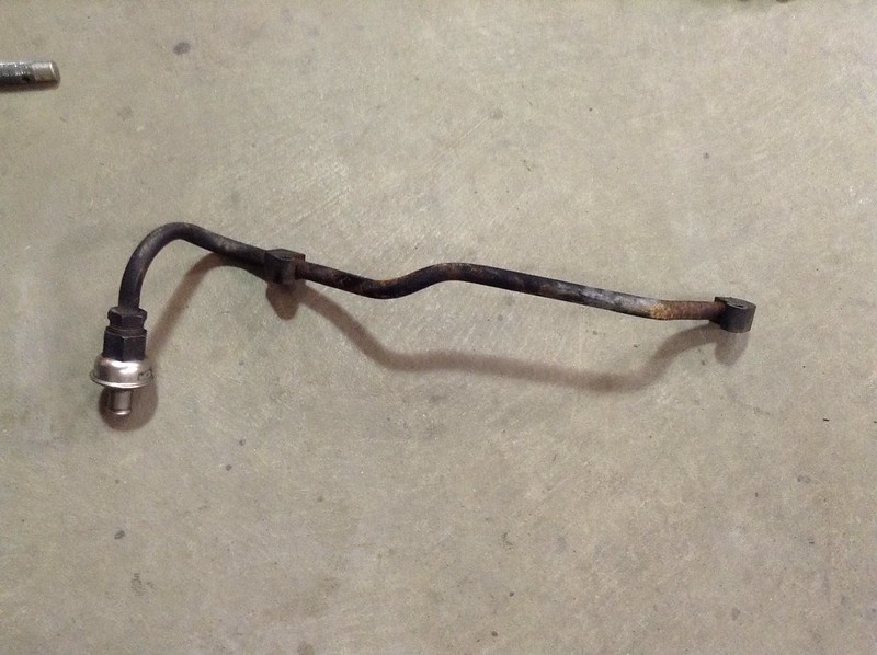

After all that was done, I began to remove the hard smog line that runs under the car and connects to the H-pipe.
I decided to just cut it in the middle instead of busting my knuckles trying to twist it out.
Hard smog exhaust line removed.
After that line was removed I began removing the other hard smog line that runs to the back of each head.
I had to remove 4 hoses total: 2 rubber heater hoses, and 2 hard AC lines (thankfully my AC system was already empty/depressurized).
But before I did that I drained some coolant so that it wouldn't be pouring out of the hoses. I then maneuvered, the last hard line out.
Second and last hard smog line removed. I'm waiting for smog plugs to be delivered so I can plug the back of each head where the line ran to.

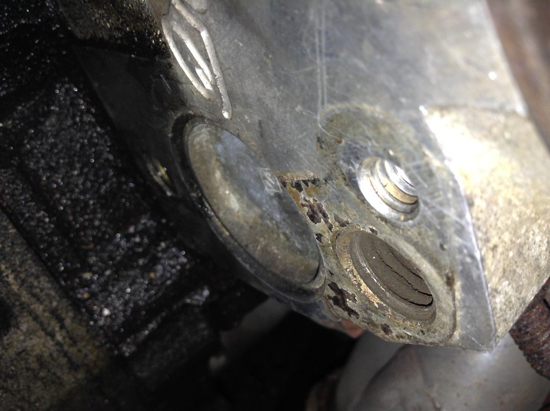

Went to the garage yesterday. Unfortunately the 5/8 thread smog plugs I ordered from LMR were slightly too big. There's a guide that I followed to remove the smog system, and the guy recommended a 9/16 coarse thread bolt.
Started off by plugging the smog holes on the back of each head. I used the 1" 9/16 coarse thread bolt with 3 spacer washers.
As you can see there was a decent amount of carbon buildup (bigger hole) which prevented me from getting the bolt in easily.
All I did was run the bolt in and out a couple times which helped loosen some of the carbon.
