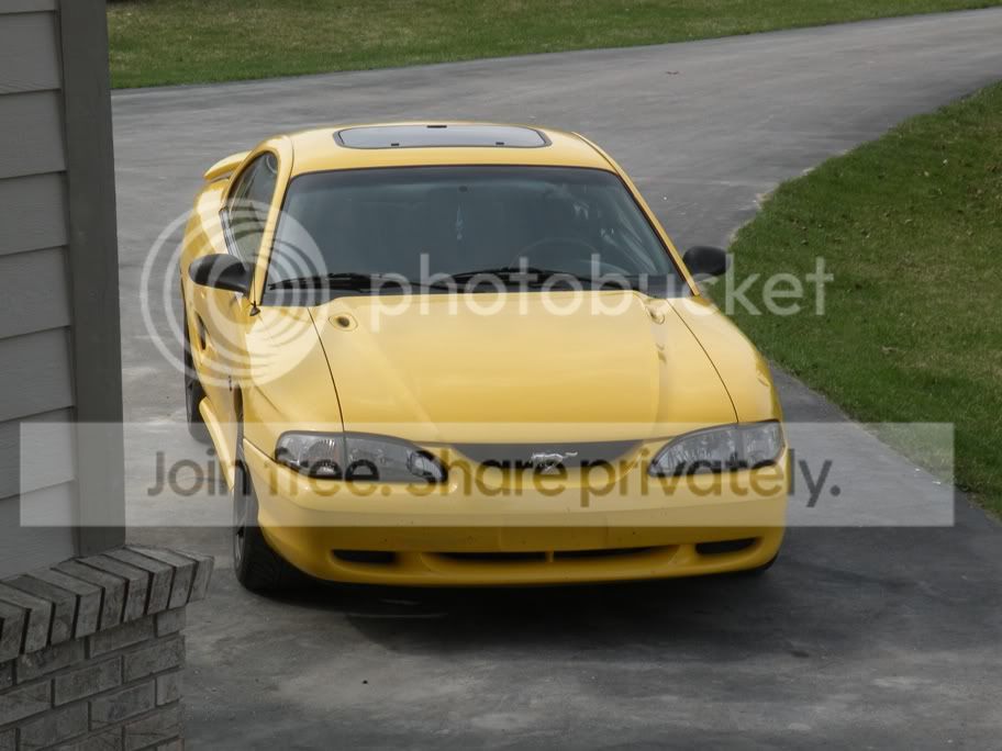

as you can see in this pic after i lowered my car with the H&Rs, my front two wheels seem to lean into the car quite a bit. I know this isnt going to be good for my tires at all and will eat them up much faster than normal. so i went to a shop to get an alignment and they said with the stock plates now i dont have enough settings to get an alignment. Ive never heard of this beforehand and am kinda pissed cause i dont wanna spend any more money on my car right now. But i have to buy some caster/camber plates now so what do you guys recommend as far as brand and website??? like i said, im already kinda pissed i have to buy these so im hoping i can find them fairly cheap...

Did they tell you what the camber was? Camber doesn't eat tires as much as people think and you can get away with pretty aggressive camber without really tearing up your tires as long as your toe was adjusted.

well it drives straight down the road so he told me the toe must be alright then if i can let go of the steering wheel and it drives straight...so do u guys think i shouldnt be worried about it then if the toe is alright???

Your car will be able to drive straight and not pull left or right, but most people experience uneven tire wear with a drop of more than an inch. I would go for the Maximum Motorsport CC plates. You can get them a tad cheaper and free shipping from atomicperformance.com

you can get by for a while without the cc's. Keep a close eye on the insides of the tread as that is where it'll wear first.
My wheels look like yours with the camber off some. no steering issues. but the tires do wear some.
just because your car drives straight does not mean the toe is in spec. My car was toed out and still tracked and drove straight.
