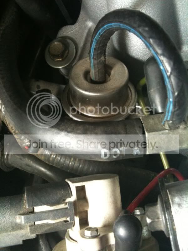

anyone know where to get the hardlines that go from the egr valve to the line that goes into the fenderwell. green and red harlines. one cracked in half and i think thats why i got the insufficient vacuum to the egr

I am looking for the red, green, and white hard lines. Anyone know where to find em?

they're vacuum lines. they don't need to be color coded. you can get that stuff at the parts store of your choice

huh. ok i guess i know where im going on lunch today!
if i can get those fixed, i think i should be good to go.
