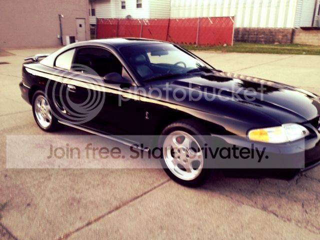

Looking for a good cam for the 165 afr heads, right now 2031 cam. Motor had a good bit of chatter after investigation and variances in valve adjustment found that the cam was worn. The local mustang tech that works at the dealer was nice enough to take it home for a couple days and pull covers . He said it was a improper install and doesn't have time to replace, He did mention getting a e303 new rockers, lifters. I am not comfortable and don't know enough to do the removing and install, if anyone knows of a good place to take it within a few hours from Charleston WV let me know.
