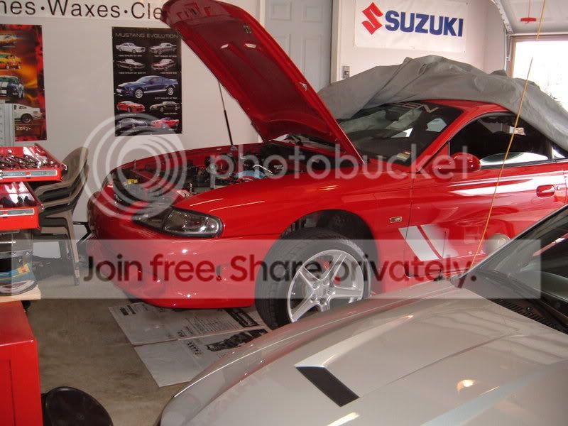

Well I decided it's time to finally change my clutch. I had Spec (stage II) in my car and it was too agressive for my taste. It was catching high + when it grabs it gives you a whiplash. So I decided to go with King Cobra. This project was a nightmare Since I have a BBK Long tube headers me and a buddy of mine (BoostinS281) had to pull the motor out and take header off in order to pull tranny out. Everything is changed now we are putting it back together. New parts are; Pressure plate, disc, throw out bearing, pilot bearing,clutch cable, firewall adjuster, and clutch fork. Here are some pics of progress.
Question: Once clutch cable is disconected should there be nay play in clutch fork? (like you can move it left or right)
