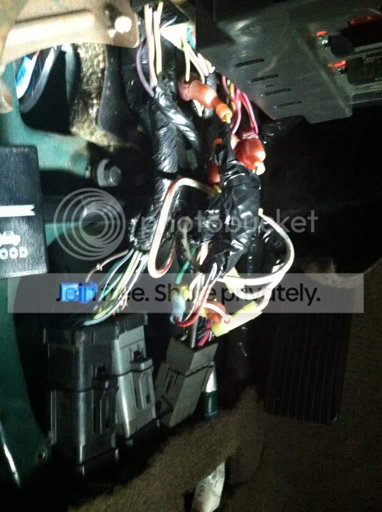

willing to bet you will find a completely different alarm system up under that dash in addition to the stock one that is in the back. It looks like an old code-alarm led/switch combo which was the manf for the stock alarms. It was commong for dealers to order a car with out the alarm and then install it on the lot when the customer requested it. When this happened they didn't just plug in the factory piece but install a completely different system that used the same remotes(two large square buttons, on arm/long the other disarm/lock). These were often hacked in by the dealerships mechanic that knows nothing about alarm installastions. The wost DIY installs I have ever fixed were mechanics cars and electricians cars, audio security is just a little different area of those sections...
Pull out the drivers kick panel and take me a pic, takes 3 secs and will tell me alot....

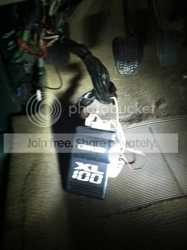

Alright I'll do it in a sec, just got home and boy was it an interesting ride LOL.
When i got in the car and shut my door the fogs flashed and the horn beeped. I thought that was weird but went about my business and had to stop at the gas station to fill up my car. I shut it off, get out, and start filling up my car and then next thing I know my horn is blaring constantly. I pop the hood, start wiggling the negative battery wire thinking I didn't tighten, didn't stop the the horn. Wiggle the positive wire and a couple seconds later it shuts off. I don't know if that was what shut it off or if it's on a predetermined timer but the alarm is batshit crazy. now when I switch back and forth on my remote it doesn't change the way the car locks at all. This may be the cause for my issues, but we'll see I suppose.

okay alarm is still tripping balls even now that I'm home. found out the alarm is on a timed setting to stop blaring the horn. so it wasnt the wiggle on the battery lol
Something tells me this harness is not stock...

BINGO. Clifford XL100 Immobilizer. Found the source of the problem buried in the kick panel haha. thanks Scott!
Now... help me unwire/remove it! lol
37,642
7,761
fawk, scotch locks, those have no place in car security and can cause a problem after a few years. Now the bigger problem is that clifford uses a normally open starter kill so there is a chance just pulling the alarm will mean that your car will not start. Disconnect the hrns going to the alarm and see if the car cranks. If it does then you can just pull each wire from the scotch lock and not worry about it, if it will not start you will need to reconnect the starter wire.

Didn't see this reply but I did have Jeremy (g36 monkey) around to help me out. Decided just for now because those scotch locks are such a pain in the ass to remove to just cut the wires, wrap them in electrical tape and call it good till the weekend. I just need my car driveable until then. I cut everything out, There was nothing tapped into the starter, so I just cut everything and taped it. Sort of a hack job but good enough for now. Car starts and runs fine by the way. I appreciate the help and will update as we go along. Who knows, I may have my cruise control back and not know it.
Pics of me rampaging the alarm:
My electrical Tape mess:

those red connectors just pull off of the scotch locks, then they just unclip and fall off but be sure to put some tape around the place where they use to be.
I am almost suprised that it starts as the white wires (one with red stripe) are the starter wires. Maybe this was a different model that is normally closed, dunno. When you get in there and disconnect those wires make sure that the wire hooked up to that one is connected or it will not start.

ohhhhhhh, yeah I used a butt connector and reconnected the red/white wire together again lol.

ahhh I thought you had to do something as I can see where it was cut and connected. That is one of the few brands that uses the normally open starter kill so that even if the theif pulled the alarm out it would not start with out connecting that wire.

Well needless to say, that alarm isn't going to be plaguing anymore vehicles, I beat it with a sledgehammer....
I can dream can't I? lol =P I did relatively well for not knowing too much about electrical this time around. Hopefully my bandaid holds until the weekend when I can clean it up and make it look a little more factory...
