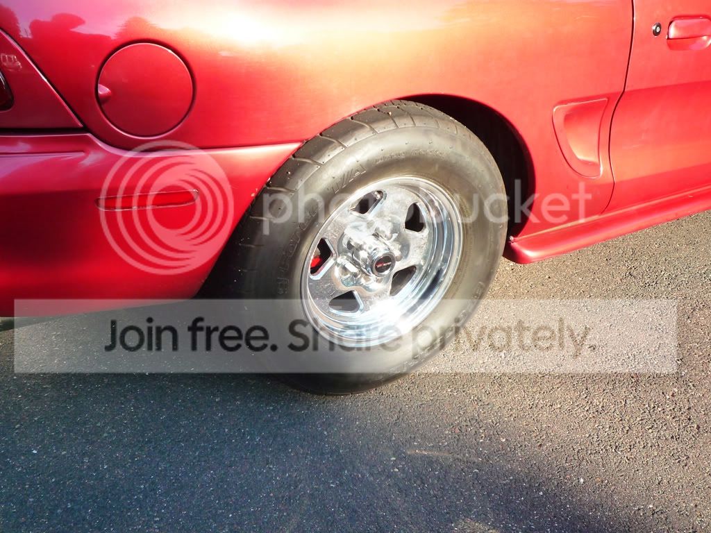

This is my car with 275-60-15 BFG DR's on Centerline wheels

I had 15" centerlines on the front of mine, just needed spacers to clear the brake calipers
