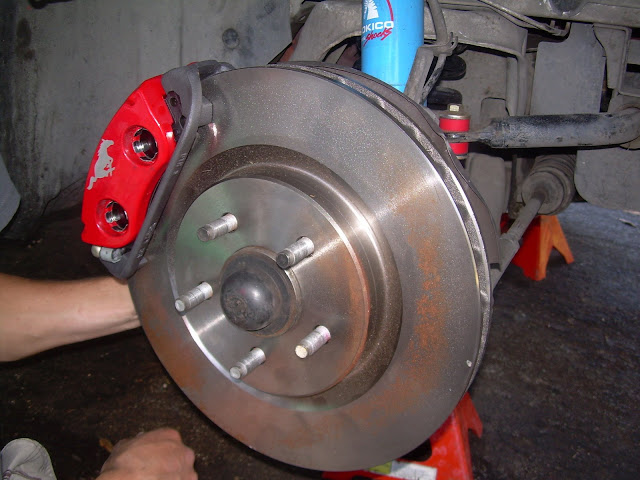

I don't see how it will help, but there is a picture of my Bullitt brakes.

im having a problem with installing my cobra/bullet brakes
what holds the caliper in the bracket?
i marked in red what im talking about in these pictures of my brakes.

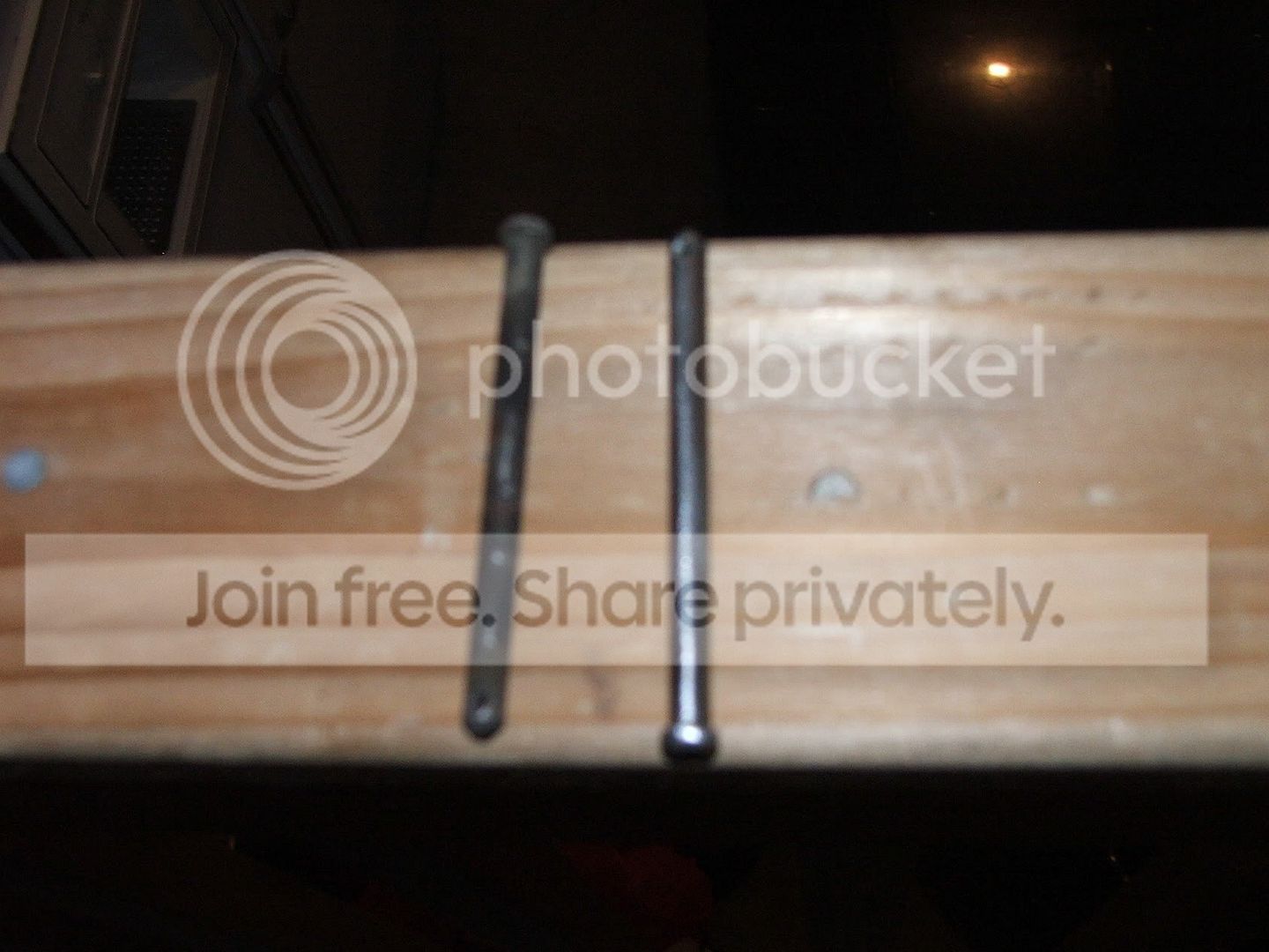

There's a pin (about 3" long) that slides through that hole and the opposite end of the pin gets an e-clip that holds the pin in place
You can see the head of the pin on the left side in the pic below.
The pins look similar to these

those clip onto the brake pads. in the above pic with the red caliper just below the pin you will see it on the pad. just keeps the pad held secure from back and forth movement
