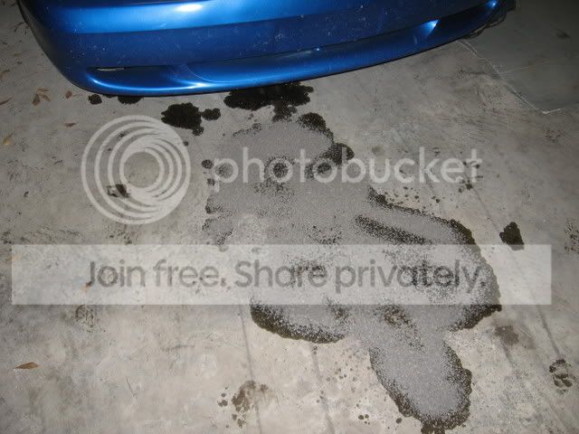

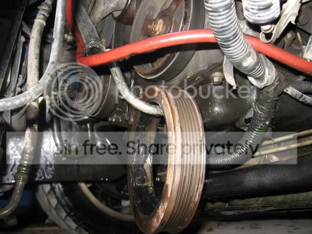

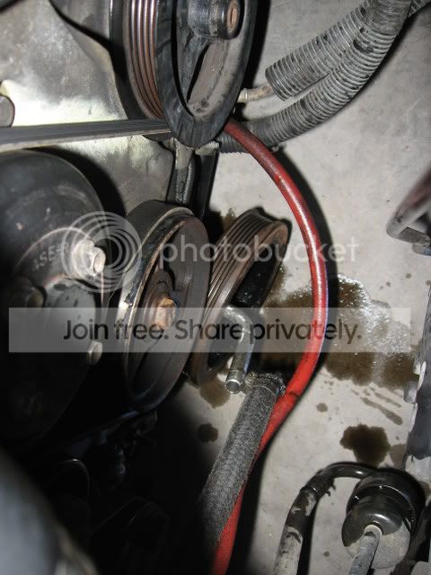

Thanks you. I hadn't pulled my broken damper off yet to see, I was going to order one and do the job all in one sitting. Mine came appart 1/2 mile from the house, and I didn't here it, car was running great. I wouldn't have know had it not sepperated and flew forward and then knocking my oil retun from the blower loose, dumping oil on the ground. and then hanging itself on the oil return rigid line like a horse shoe. I can't believe the belt stayed on.

oh, ahahahahah, mine did the same thing, except it didnt come off all the way, and it was making a horrible clicking and clanking noise. good thing was that it was in my driveway. bad thing was that i was on my way to get my car washed for prom that night. :hammer:

Yeah, if it hadn't knocked the oil line loose, It would have slipped by me for a while, especially with the belt still on. Trick trick, never in a million years can this happen again.
