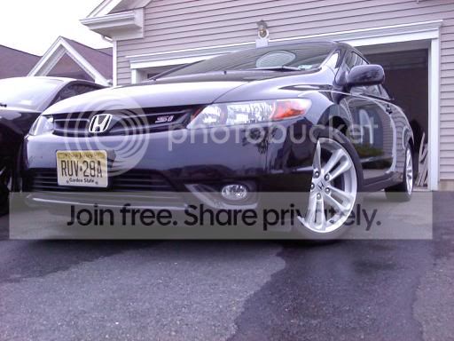

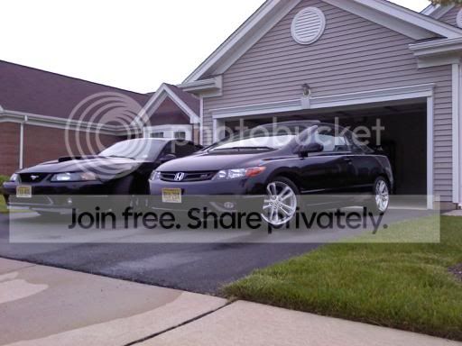

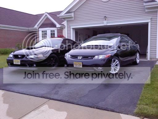

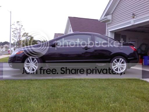

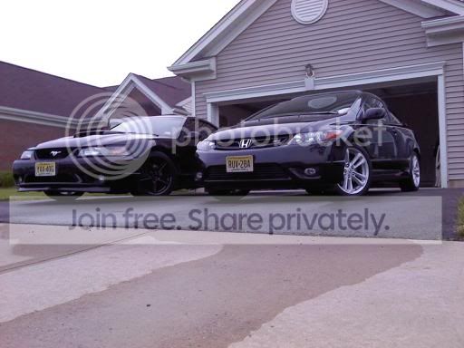

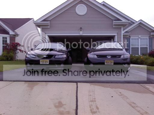

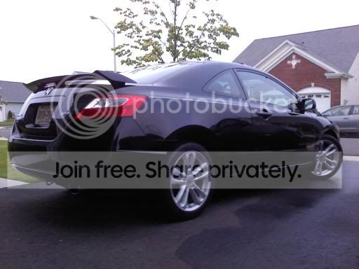

did my car yesterday did my dads si today:
wash:
microfiber mit
dishwashing soap
claybar:
meguiars clay
meguiars quick detailer spray
compound, polish, glaze:
Meguiars M-105 ultra cut compound
with red meguiars compounding pad
Meguiars M-205 finishing polish
with yellow meguiars polish pad
forgot the brand glaze ill find out tomorrow
with black meguiars finishing pad
wax:
meguiars gold class

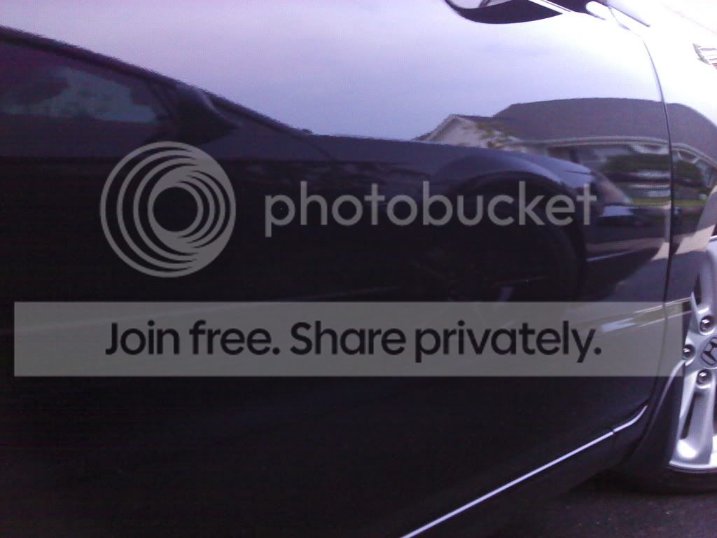

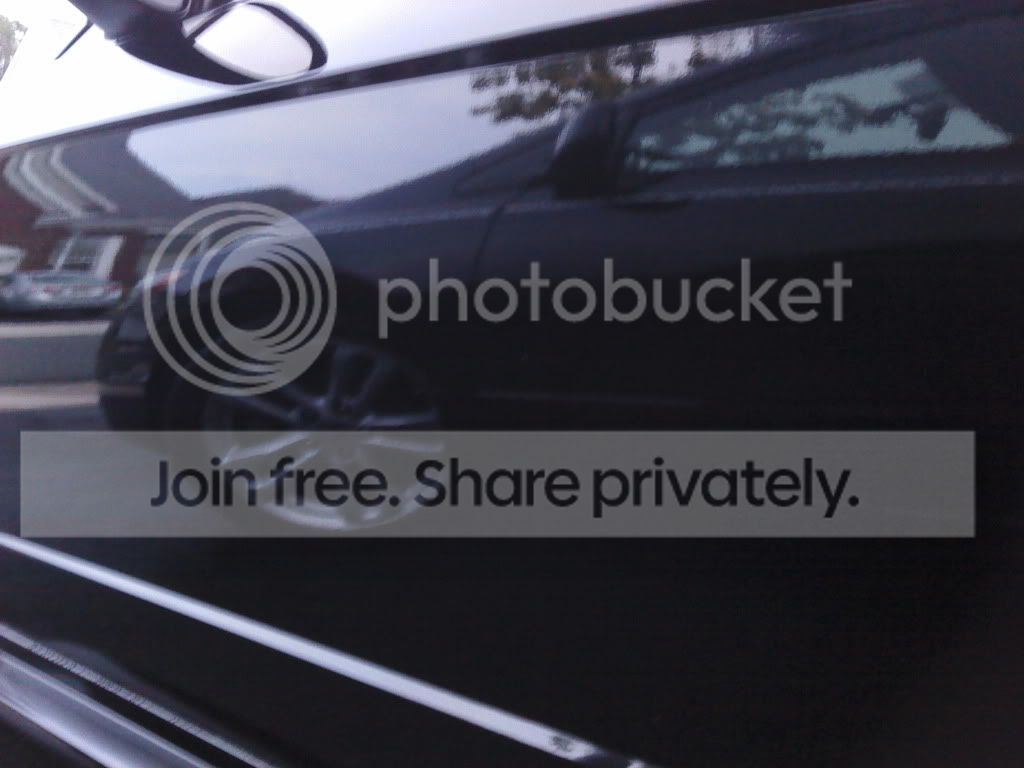

idk either... no before pics but put it this way, it commutes 5 days a week to jerseycity and had ALOT of swirls and scratches. i used a chicago electric variable speed polisher, so it wasnt technically done by hand
