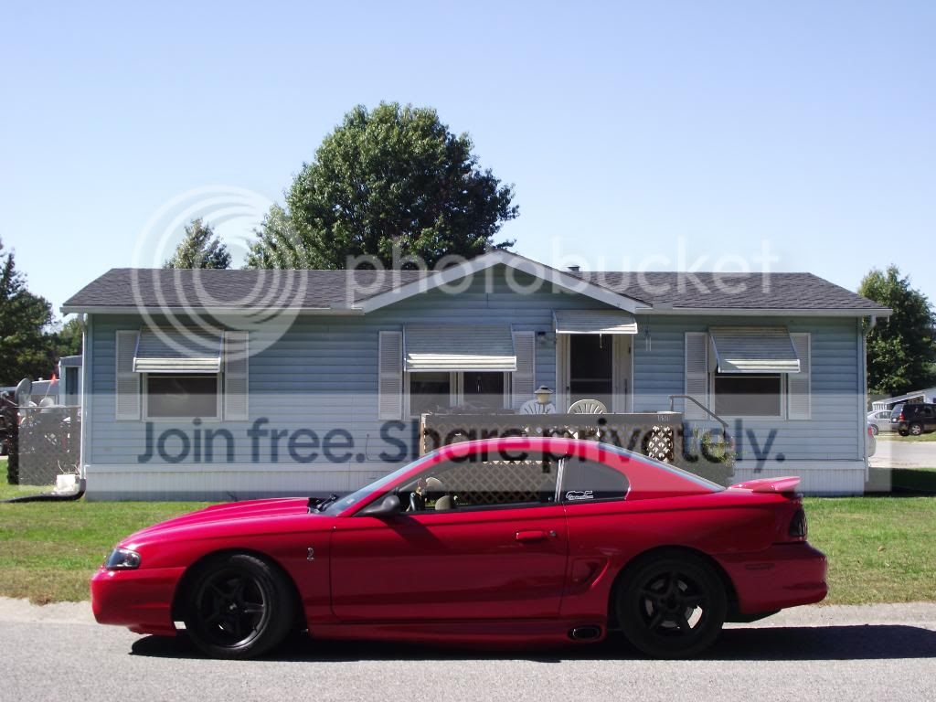

Ill upload some of my old Cobra later when I can get a computer. Mine was lowered on sportline springs and kyb agx struts and shocks. Only thing I had to do was tuck my exhaust closer to the body. The ride was excellent even on bumpy roads, only modification I did to my driveway was put gravel in front of it so the transition was easier
37,641
7,760
riosnake is a little lower then I would like, I can't imagine he isn't scrapping everywhere... I just got teh subframe connectors and hope to get them installed in the next week or two.
He told me doesn't just cause he's used to it, either way it's not gonna make too much difference with how low the skirt is going under the side tips. Mine fits under the subframe connectors but man you lose so much ground clearance because of it.

My ride is fine, the only thing I ever scrape is the midpipe pulling in the garage.
