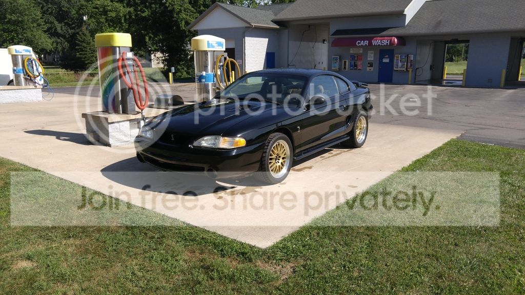

Peeled the dip off the wheels yesterday, and I really like the gold, just needs more low.

I like the gold on there. I think doing the side cobra emblems gold will fit right in. It could go a little lower, but not excessively.
Great looking ride man.

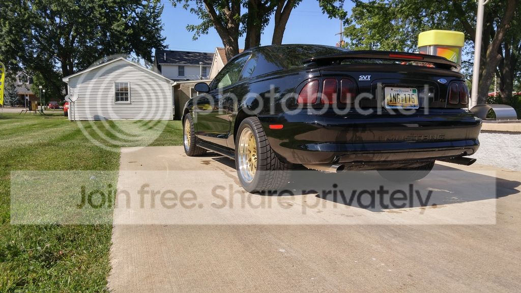

Picture Update
Decided to get the cobra out and finish everything with the suspension and get an alignment. Turned out pretty well I think.
But after doing some back road testing with the new setup I knew I was rubbing when I cornered hard.
Both rears were rubbing on the inside wheel well right above the exhaust, so I promptly grabbed a hammer and bent a 6 inch long area up 2 inches on both sides. After another test, my hammer modifications seemed to do the trick.

You might want to check the rear upper and lower control arm bushings. Mine were destroyed and allowed the rear to move from side to side causing my 315's to come into contact with the inner fender under hard cornering.

Thats what it is, but I'm not going to pull it back apart yet because in a few weeks I plan on ordering MM Lower Control and maybe upper too if they sell them. For now my hammer procedure seems to have done the trick, the only thing that really irritates me now is this play in my steering wheel, already ordered a MM Solid Steering Shaft (http://www.maximummotorsports.com/S...Power-Steering-Rack-1994-04-Mustang-P460.aspx) Hopefully that does the trick, if not I might find myself a 03-04 cobra rack and slam it in.
