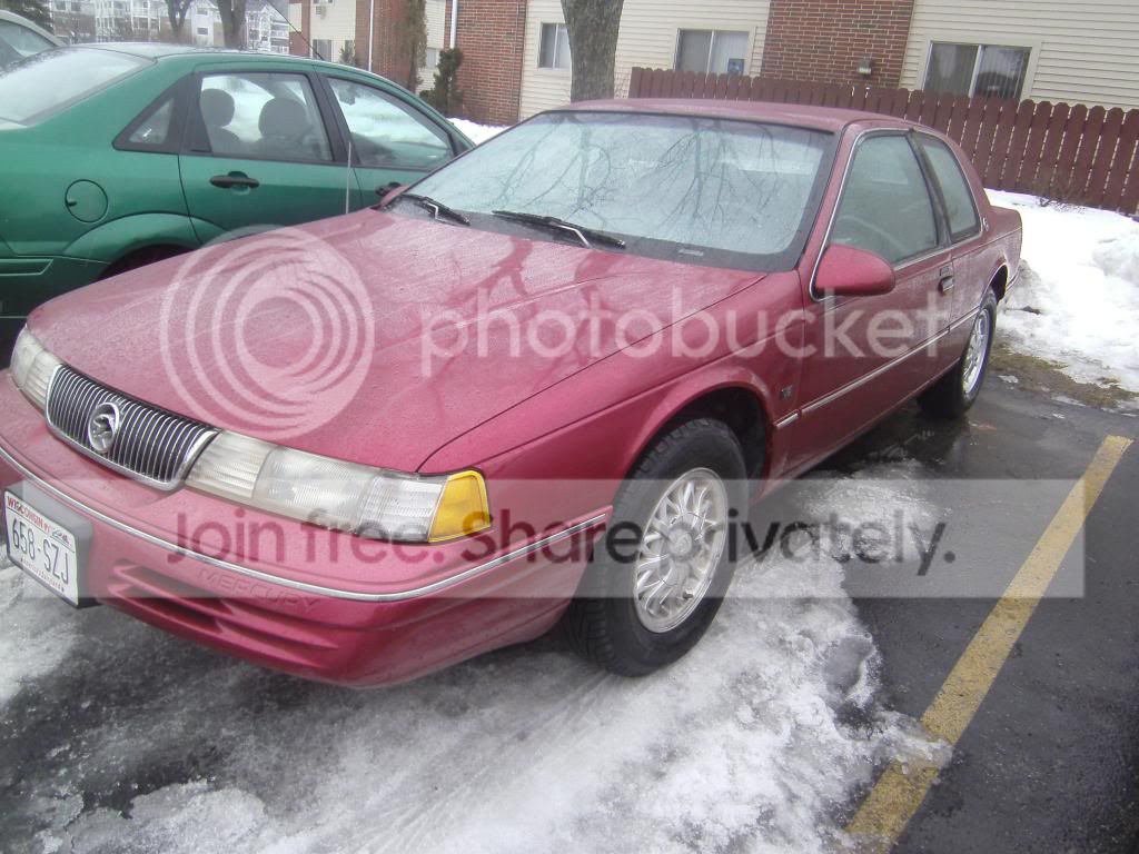

pictures speak for them selves....Im kinda noob to 5.0's so what im asking is....Im always on a budget so what are the best bang for buck bolt ons for this eng... headers are expensive since this is a mn12 frame not mustang but if stang headers fit I don't know as of now..Is a 70mm throttle body worth it if snagged used?? what about the smog pump and other 5.0 stuff I know nothing about that I can delete, NO EMISSIONS !!!!!!!!!!!!!!!! YEA!!!!!!!!!!!!!!!!!!!! car as of rite now has absolutely NO issues, perfect idle, pull blablabla..just needs a starter as this one doesn't always enguage the 1st crank, a windshield as it has a crack by passnegers side, an antenna and sideskirts yesyesyes I know I know..some how the outers on the very lowers rokcers is rotted even though the underbody still has factory color and not a spec of rust..these cars had a problem withnot draining water from the rockers,all ford needed to do was drill a hole in the bottom front and rear of the rocker for it to drain...ugh...o well..here she is and miles are correct !
I do already have a explorer upper and lower but I know it wont clear my hood but ive read I can use the explorer lower with my upper,is that even worth it at all? I also have an 80mm mafs and 24lb injectors, I know I don't need the 24's yet...

Nice Cougar brother!!!
Try this combo for easy fun:
Custom cold air with a Cobra MAS maybe?
94/95 Cobra intake
70mm throttle body
1.7 rockers
better shorty headers
As for emissions, ditch the smog pump/bracket, cap the tube leading to the cats and run a shorter belt
