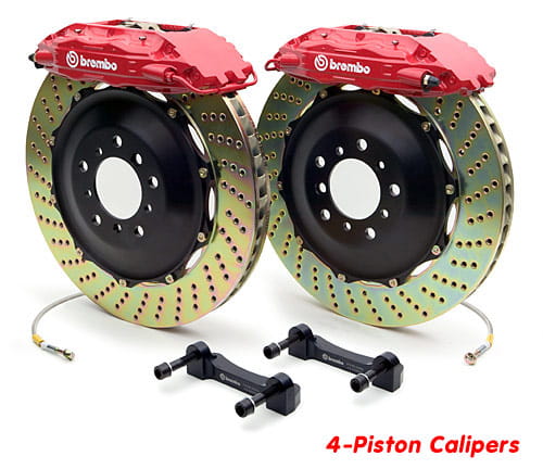

Another option is the Big brake kits offered by Brembo.
My car with Brembo GT kit.
Pros with this kit
massive 13.02 X 1.25 two piece rotors.
Very large Brembo F40 4 piston fixed caliper.
Goodrich steel braided lines.
Looks great.
Brake pads are easy to change.
[Cons]
very high price for the kit. list price is $3595
high price for replacment rotors. New Brembo rotor rings list for $650 each.
High price for brake rotor mounting hardware. $120 list price.
Brake caliper will not clear most factory wheels.
Brake rotor will not clear the factory tie rod ends.
