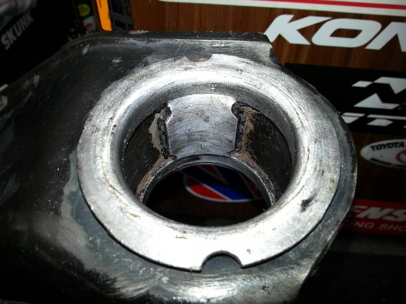

Well the arms I had were non cobra arms I'm pretty sure. There is the arm, the outer cage, then the inner cage, then the bushing. Let me see if I can find a pic

That's the outer cage, picture a bushing inside that with another cage around it.
