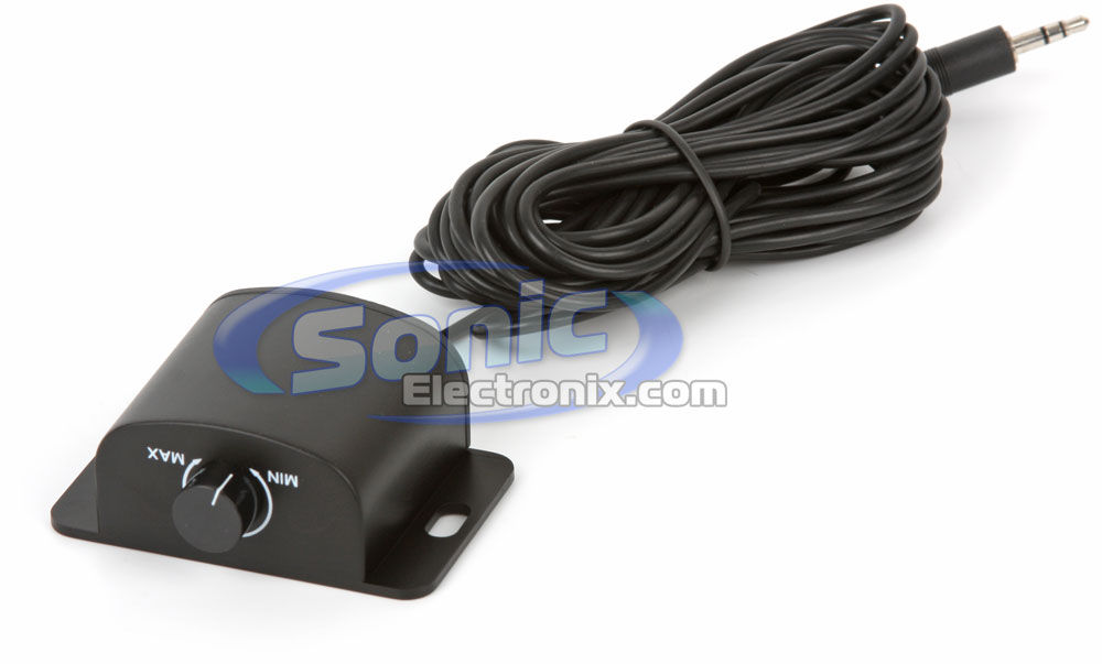

The JL amp I have is missing the remote gain control knob, and I cant find one online anywhere. Can anyone help?
37,643
7,762
ebay will be your friend there or else if you can figure out what the value of the potentiometer and make your own. Otherwise go check out your local jl dealer and I would not be suprised if their installers had one or two in the bottom of their toolbox.
