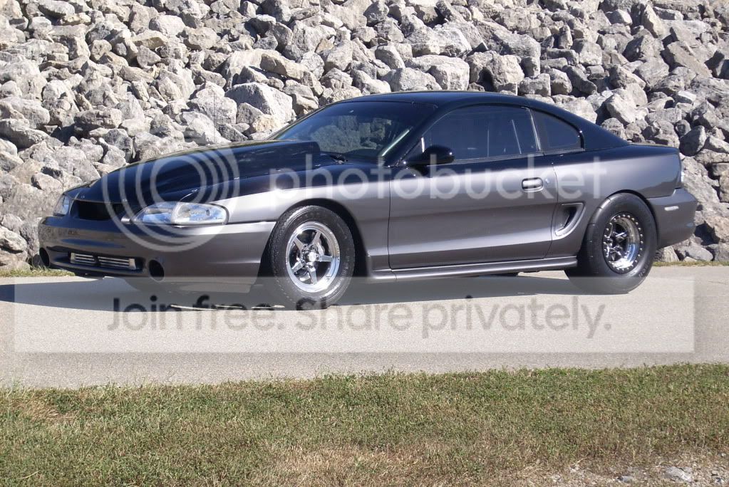

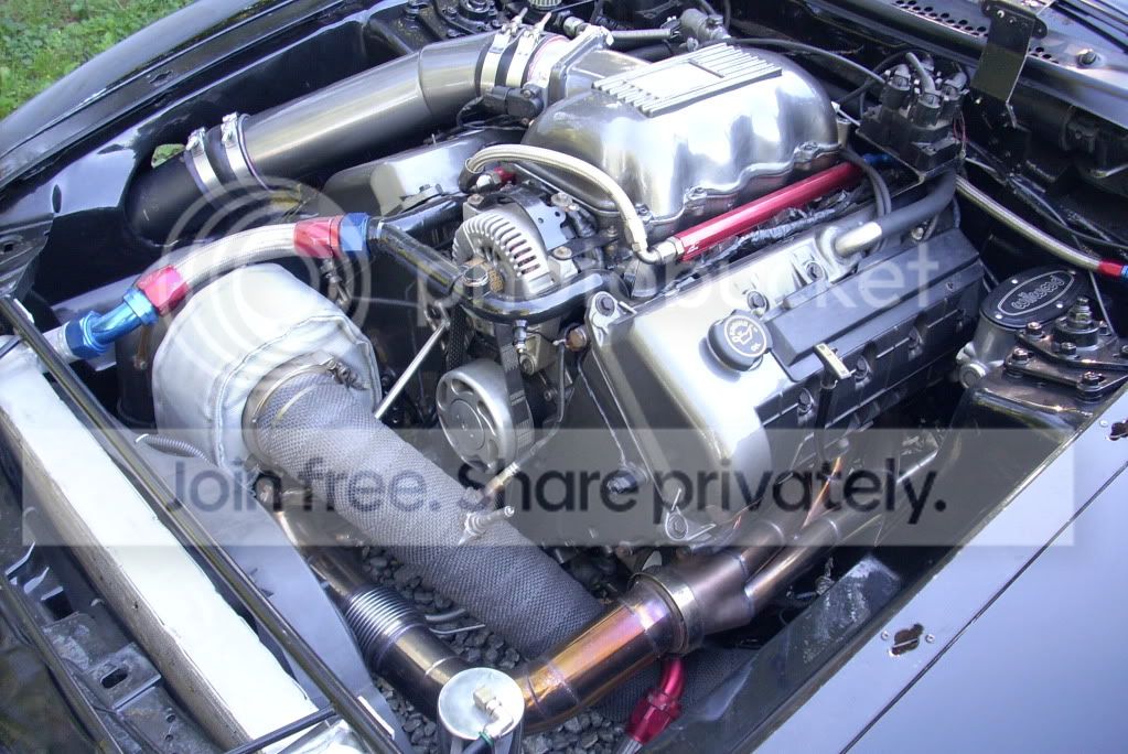

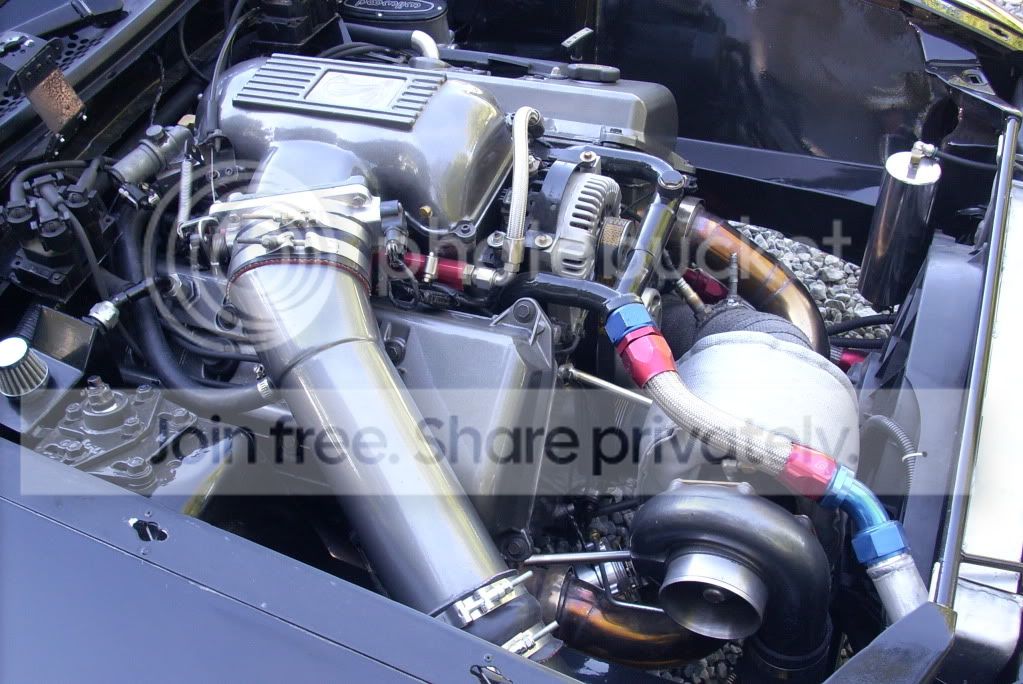

This is a good recipe for any of you Modular peeps who want to go fast, very fast without spending TOO much.
This car went well into the 8's on the last combo, at 154ish MPH. He just got this build done, and it went 9.2@160 the other day on DR's. He put the slicks on, and should be going mid 8's real soon.
4.6 DOHC - 1998 Cobra
Stock Block, bored .020 over
Diamond Coated Pistons
Modmax Billet I beam rods
Stock Cobra crank
Stock heads, stainless valves, Manley Valve springs
Stock cams
PT88-47 T4 turbo .96
4" Aluminum Downpipe and muffler
Stainless steel turbo headers and crossover all made by owner
Large front mount air/air intercooler.Same side in and out
Ams500 with C02
Stock 05 style maff with Mafia
83lb injectors
Stock intake, ported, shortend runners.
327 gear,Moser 33spline axles spool and c clip elim,girdle,braced and welded tubes
Home made upper and lower rear control arms and anti roll bar
Strange front brakes.Stock rear brakes with cross drilled rotors
Aluma star 2.0 fronts.Weld Weldstar rears Black with Black Chamipon beadlocks
MT 295/55/15 Dr's
TH400 Trans
Alot of stock parts for an 8 second car!
