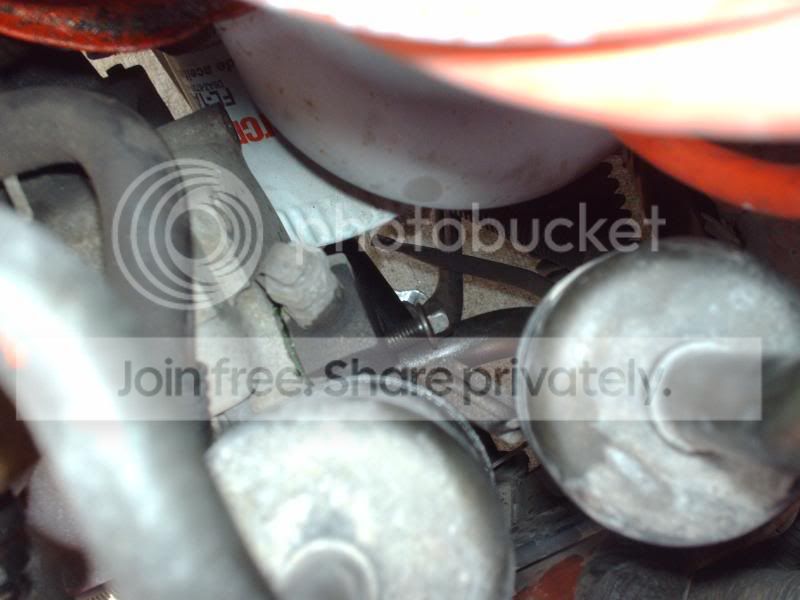

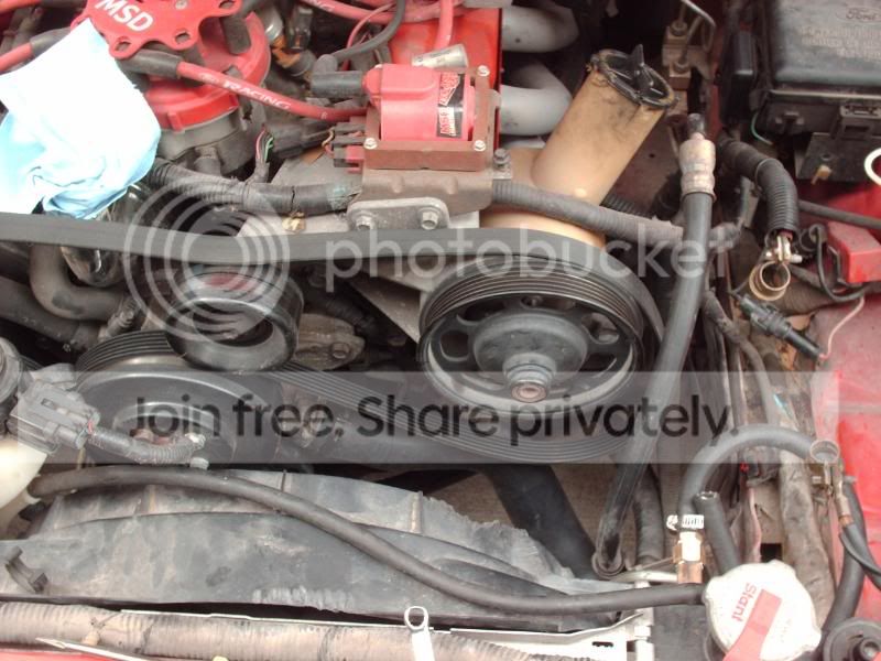

Now for the fun part the compressor. First disconnect the belt. Then on the back of the compressor where the lines go in there is a single 10mm bolt. I had to use a wrench to get this out and it was a kind of slow process but will will finall come. After unscrewing this you can now pull all the lines freely out of the car. Pics of the bolt is below.
Now the last thing to do is remove the compressor. First disconnect the electrical connection from the compressor. Next you will need to remove the 4 13mm bolts hold the compressor to the bracket. These are not in extremely tight i was able to use a normal 3/8ths ratchet. Be careful after the bolts are removed the compress will just fall. Just yank the compressor out from where the battery sits. Now all you need to do is measure your new belt and your finished. Pics will be up in a bit.
