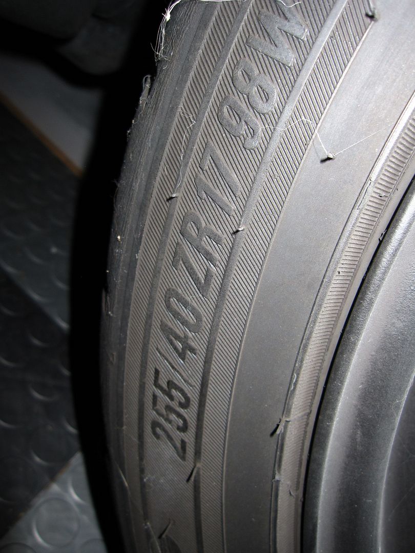

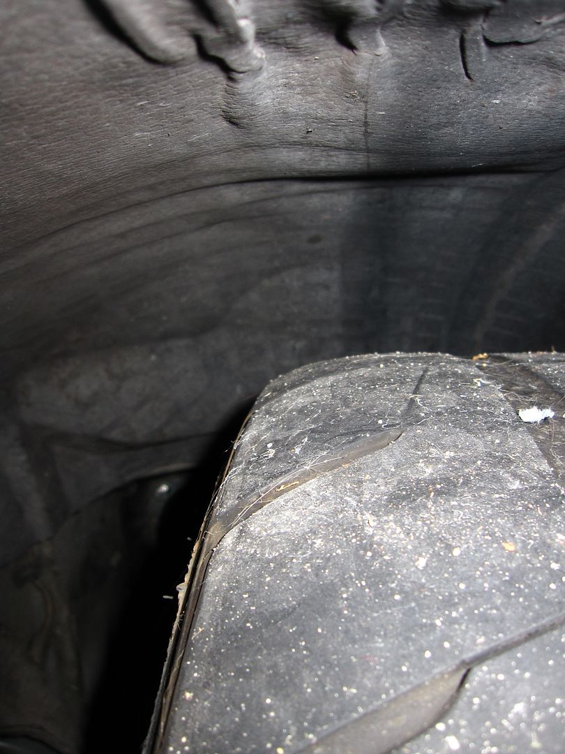

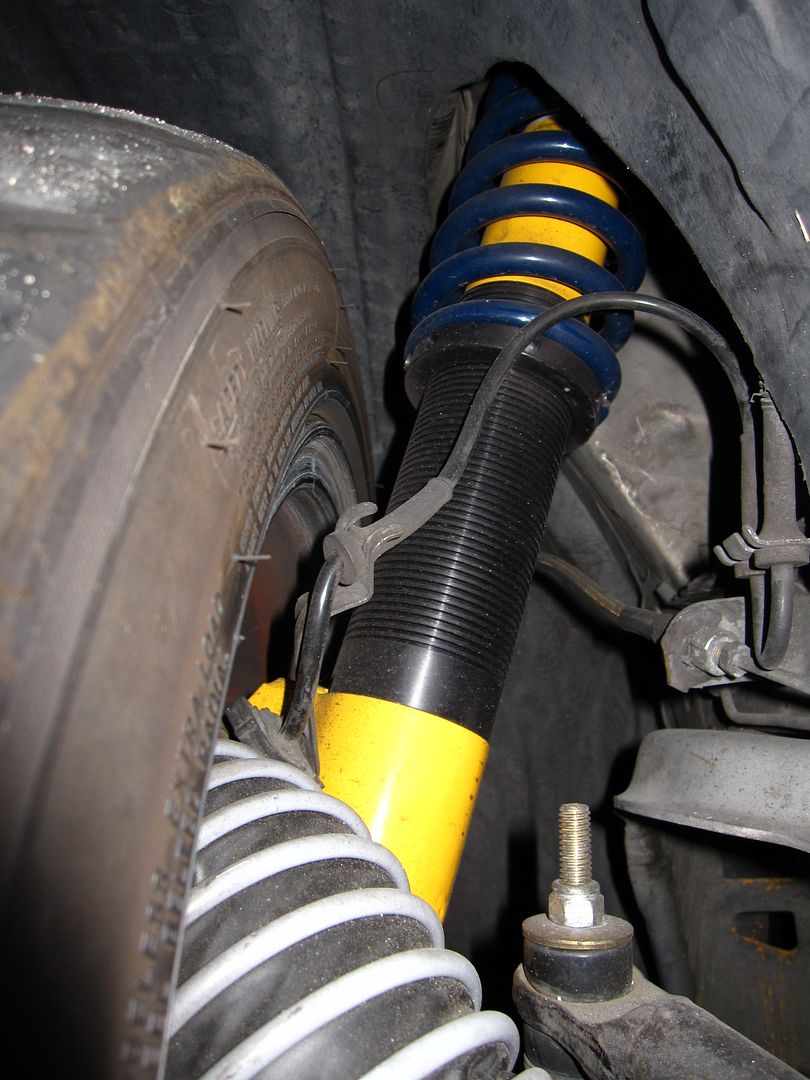

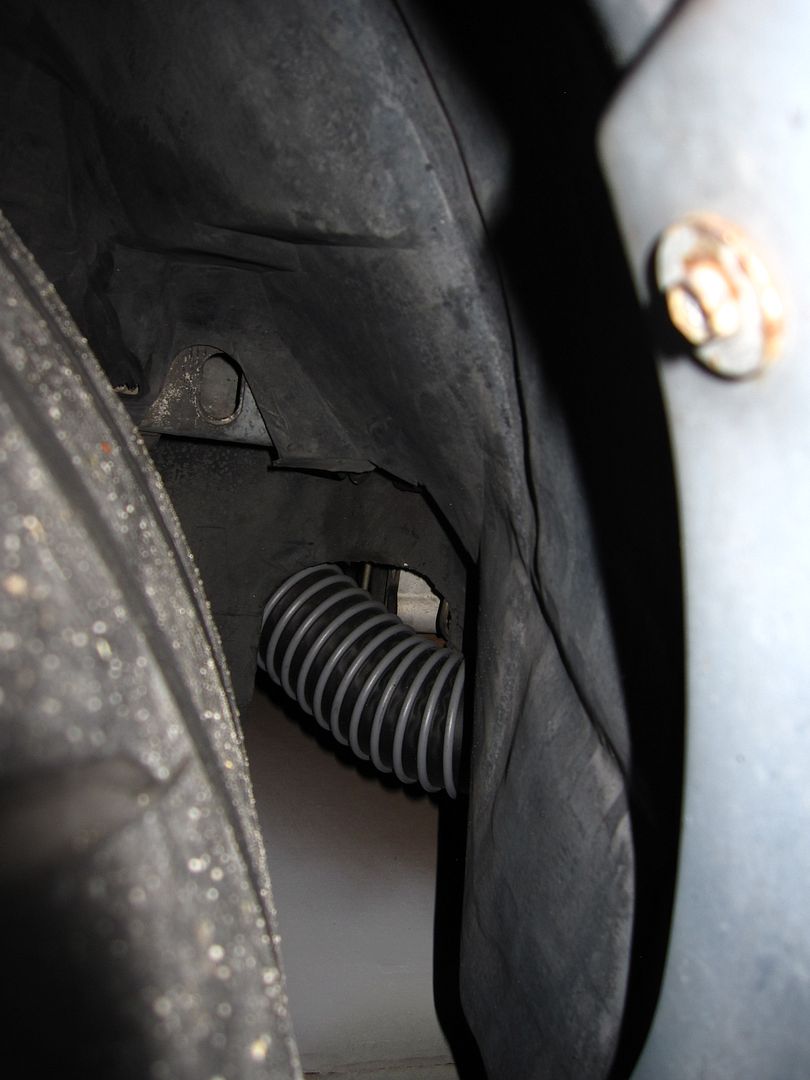

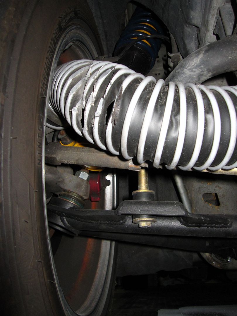

FWIW, my wheels are 17 x 9, +22mm offset. My tires are Nitto 255/40's. They most absolutely do not rub. Here's pics of clearances:
The only rubbing here is on my brake duct hose (which I didn't realize, glad I took the pic lol). Otherwise, tons of space:
Clearance to the front fender well:
Clearance on the rear of the tire and towards the top of the wheel well:
Plenty of space all around. If you are rubbing, then something is wrong. The first place to start is your offset on the wheel and if that turns out to be correct then go from there.
