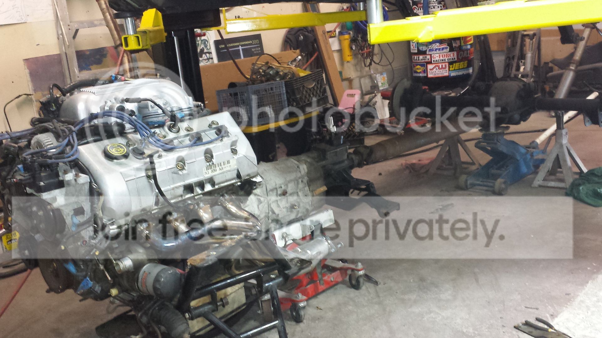

Ok I removed everything from my crashed 98 cobra and all im left with is the drivetrain , that was running before I pulled out the ignition key tumbler to remove the upper streering colum plastic and now the car wont start.. Can I remove the PATS system and hope this motor will run in my race car.. the light on the dash blinks fast then after about 2 miniutes It blinks once and then 6 times .. im thinking this is a code 16.. what does this mean.. I have tried to remove the battery and reset the computer .. I have done the turn key to run for 15 miniutes then off .. 3 times with no avail as of now im at a loss...
What can I do to get this frigging thing started.. I jumped the starter and atleast she can crank tat way
Any help would be greatly appreciated..

Ok I went out and bought a 97 cobra shell that im going to swap the drive train over into that way it is all still a cobra..
Does anyone have any suggestions on how to make my cobra motor live on the track while I have it out .. what upgrades should I do ..
