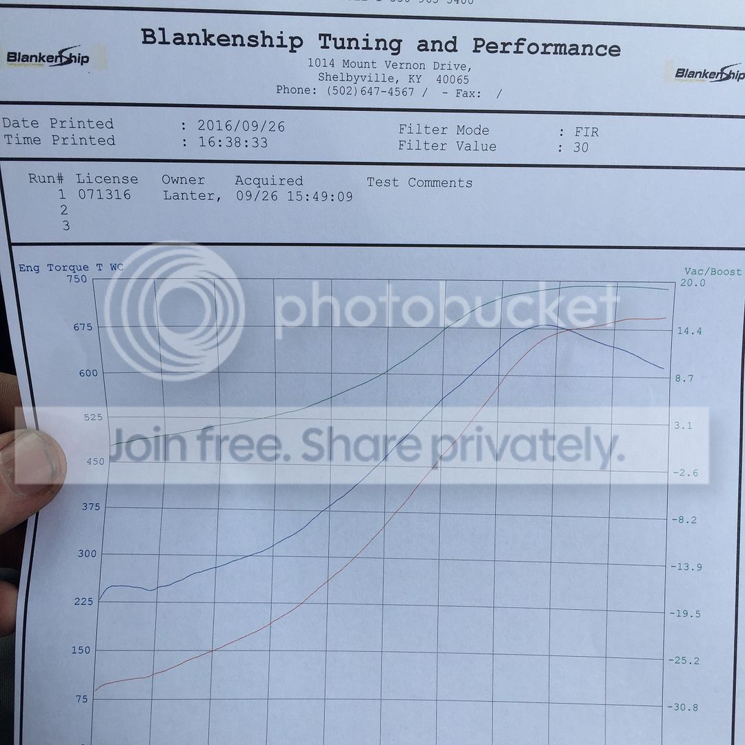

Lanter
Lanter
Jan 14, 2015
372
Indiana
numbers are in! Car made 700/680 on 18-19 lbs. We tried upping boost a bit from there but the ignition system couldn't handle it so until I get better/new coils or a boost-a-spark I'm not pushing it harder. Couldn't be happier with Lees tune, car drives like stock and pulls like madd. I haven't felt full throttle yet or up to 6000 rpm but gettin on it 3/4 throttle felt crazy lol.
96laseredcobra
Nov 29, 2015
1,422
Farmington MO
Holy shit bro. Nice!
