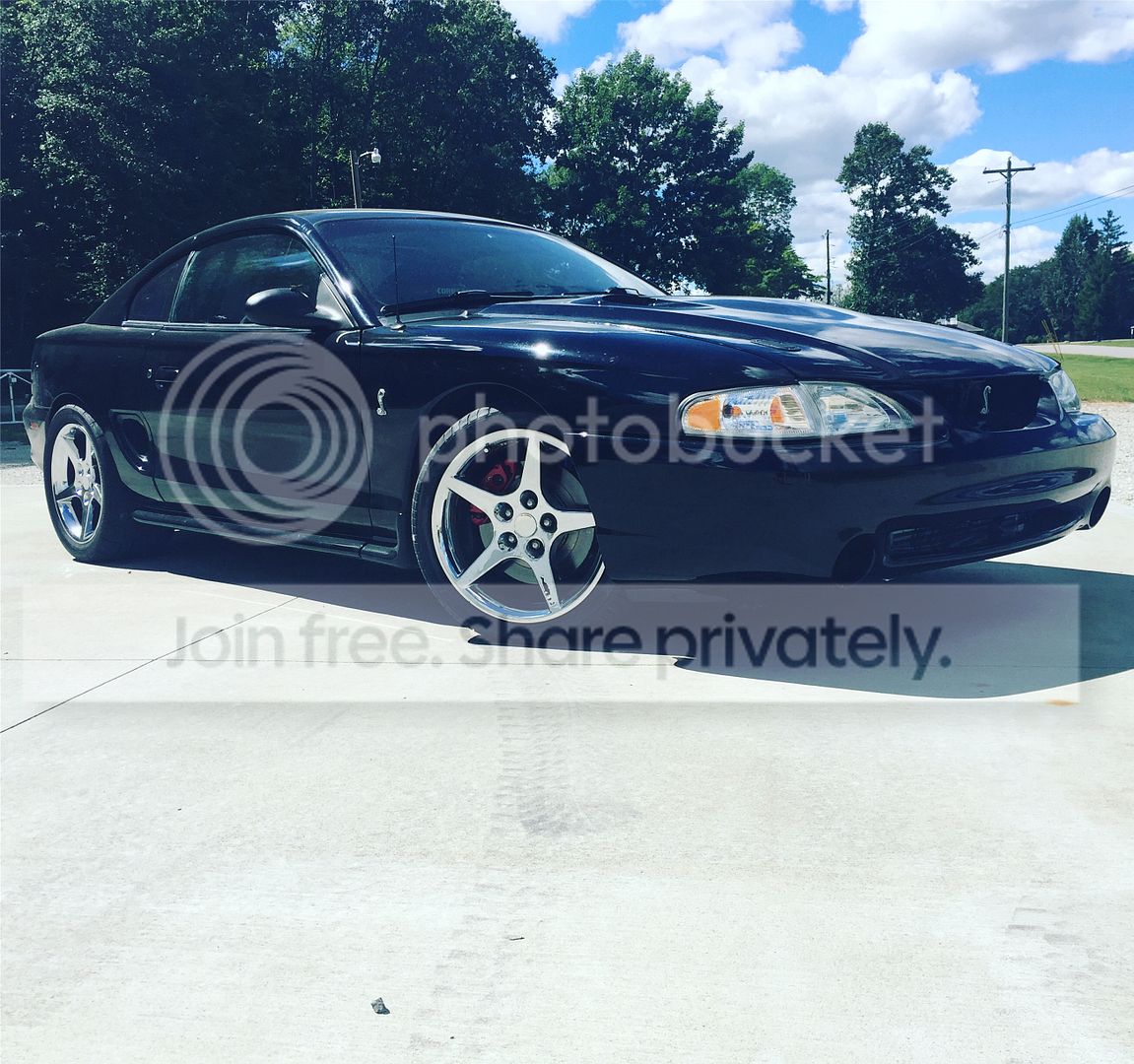

Also took the car for a test drive to make sure it's leak free and man does it drive 1000x better than before, and before I thought it drove well. Didn't have time to wash the car but took some pictures anyways, 1. because the car was leak free and such a nice day and 2. for this months ROTM lol.
