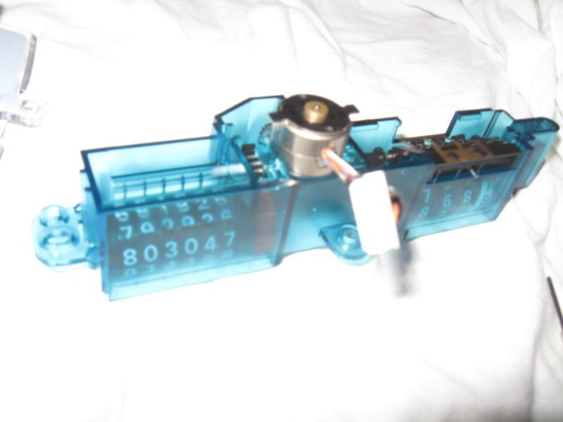

bolt in and trasnfer your current odometer over to the new cobra cluster, i did it. along with another mods..
here it is off:
here it is off:
Yea mine is a 1994, so it will just be a bolt on then...but here's the kicker...
Im from Canada, so everything is in Kilometers. The cobra cluster is off an American car, so it's in MPH.
will my car now count in miles? or will it still be km's?
so if I transfer it over, would it be possible to change my odometer to the equivalent in miles? also what about the trip counter?
