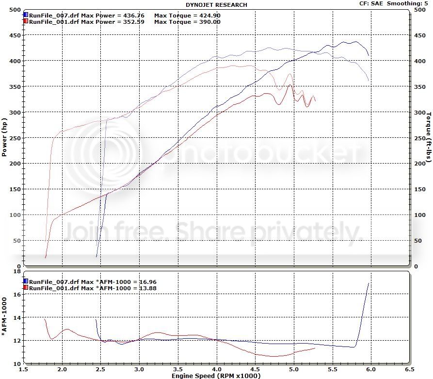

Here's my dyno sheet.

damn nice looking pull on the dyno sheet.
if you have the money to get a new block i would start pricing them out if i were you, and talking to machine shops about specific blocks. could be a good time to bump to a 306 or 331.
as far as if your safe with your block you never can be sure. a friend of mine blew up his 45k stocker with a powerdyne supercharger on 6psi.

The car goes real lean at 5800 on your graph so i def wouldnt take it above 5800rpms. Besides that you should be good but all blocks are different. Some split at 400, some 500 and 600.....
