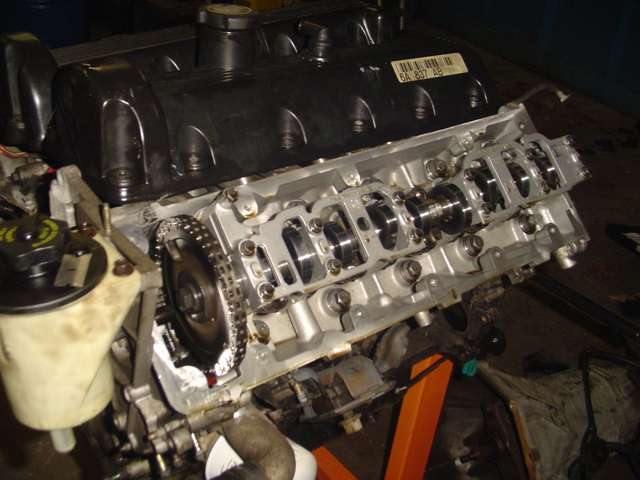

Just opened up my old motor and found this
is the cam stuff stock, I know my PI heads dont look like this
GDTrumbo
May 30, 2008
1,201
Nashville, TN
As I remember, the Romeo's are equipped with the cam "girdles" as shown here. The Windsors just have the caps only.

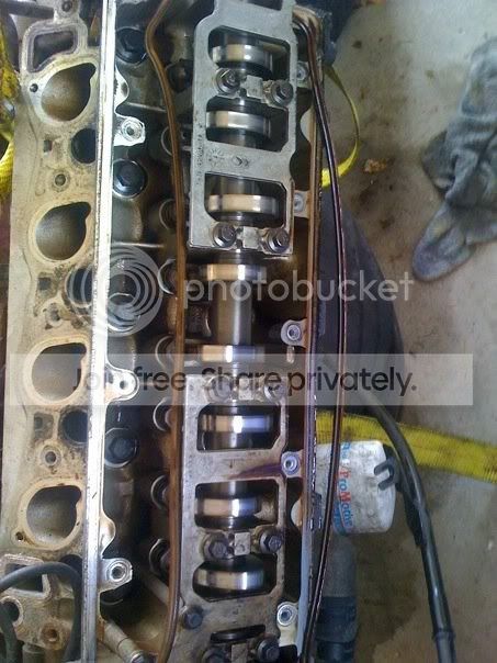

what are they for? how do i find out if my new heads and block are R or W? If im not mistaken the valve covers from this NPI motor will work on my PI motor?
NERD
Dec 28, 2006
3,016
25
Virginia

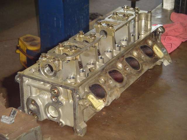

All NPI's are Romeo. There is no more proven strength in either R or W head design. It doesn't matter if you use Windsor heads on a Romeo block (or vise verse). I'm running W heads on a R block.
This is a Windsor head.
