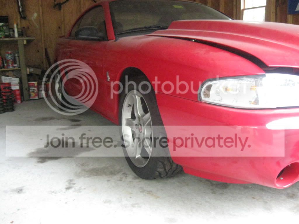

hey guys im in the middle of my build and i really need a good k-member and control arms, but all the ones ive found move the front tires forwards and says you may have to modify the fenders or fender wells, and i really dont want to move the front tires, i like them were there at lol. im a big fan of Maximum Motorsports stuff but theres move the tires 1 3/4" forward. I found a brand called "Afrco" that has some nice k-members, anyone know anything about them? thanks in advance for the help.

i just realized i put "1 3/4" lol but i havent really seen any sn95's with the mm kmembers installed from the side so i guess thats why im kinda worried about how it will look, im also installing a turbo kit so i need as much clearance as possible.
