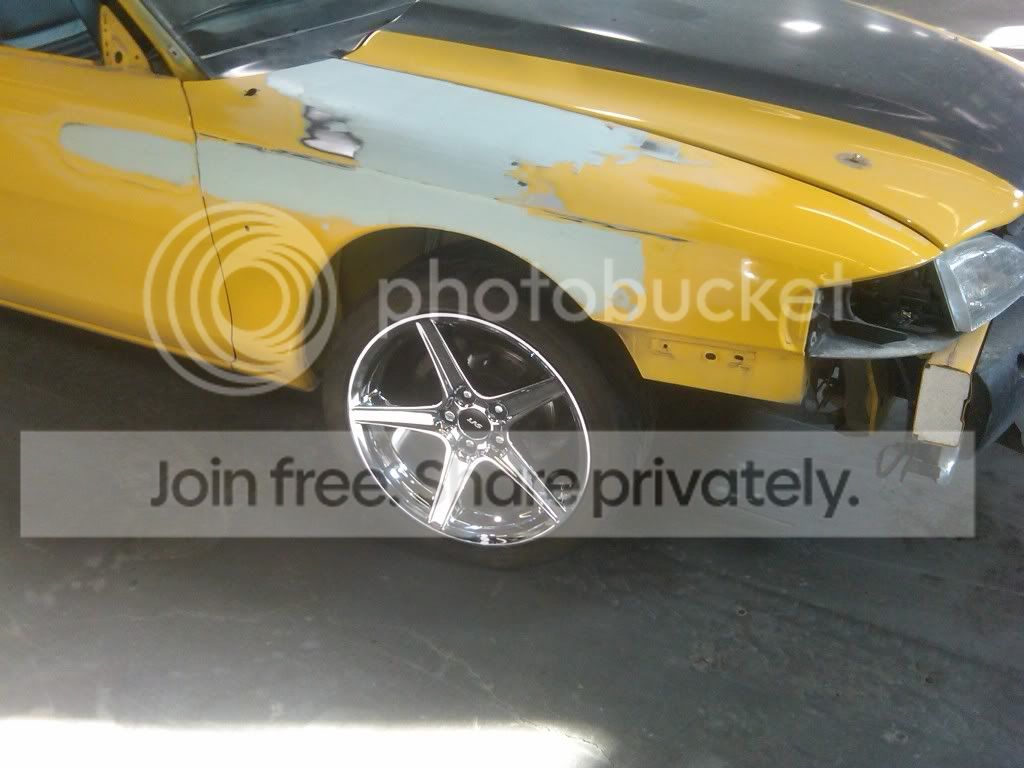

I have a QA1 K-member on my car now, had it installed free from my accident ;). They had to shave the stock A-arms a bit to get them to fit, and a few other things needed to be grinded, but the wheels were NOT pushed forward 2" at all. Here is how it sits, stock suspension up front with just the QA1 K-member.

yea the 2inches forward and something about modding the fenders made me stay away from them. but looks like it centered the wheel perfect. hmm might have to look into them more.

is the engine in the car? cuz that might change it all.
lmao no, my car just sits that high :p. I'm doing the suspension this winter so it will sit lower. They had to grind the part on the control arm that bolts to the k-member, the round part, it rubs the k-member so a little bit of grinding and they fit good :).
