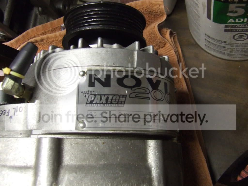

Look what I picked up today!
bottlefed97
Aug 17, 2007
2,542
12
Orlando, FL
Came with all the 8 rib pulleys (and an additional 6 rib blower pulley) and two 8 rib belts, all I need is the AC pulley because he had an ac delete on his car.
It's set up for 18-21 psi
Now I just need:
-60 lb injectors
-Oil drain-back line
-Boost a pump maybe?

All I have now is a Walbro 255 pump.
What would you recommend for the fuel system?

well, it depends on the look you want. if you want to go old school, you can sump the tank or if you want a sleeperish style, you can go with a glenn's performance tank. Then, for fuel pump's, you can run 2 or 3 inline Walbros, or run an aeromotive A1000 or run a Magnafuel pump. I've seen some really great things from Magnafuel. That's most likely what i am going to run with my project car. They are relatively quiet and have awesome flow, but they are pricey. but there are many fast, high-powered cars running them on the streets. There is a Single-turbo camaro down in south florida that just broke into the 8's with a magnafuel and i'm pretty sure the car is his daily driver. Of course, you have to run new fuel lines for this stuff, but you need to do that with the power you are going to eventually want to make.

Well I didn't really want to spend a whole lot on a fuel system. I just need few minor things right now for the power that it will make. The guy made 508 to the wheels without any tune at all, and with just a Bosch "044" inline pump, bbk fuel rails, and 60#er's

I would rather wait and spend the extra $500-750 on a real good fuel system than spending $250 on a boost-a-pump.. cause eventually you are going to want to up the boost and go faster, so then you are going to end up doing the fuel system eventually.
