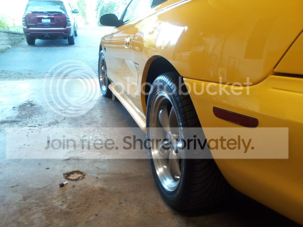

This is how my car sits after fitting VOGTLAND lowering springs, she has poly spring isolators fitted front/rear.

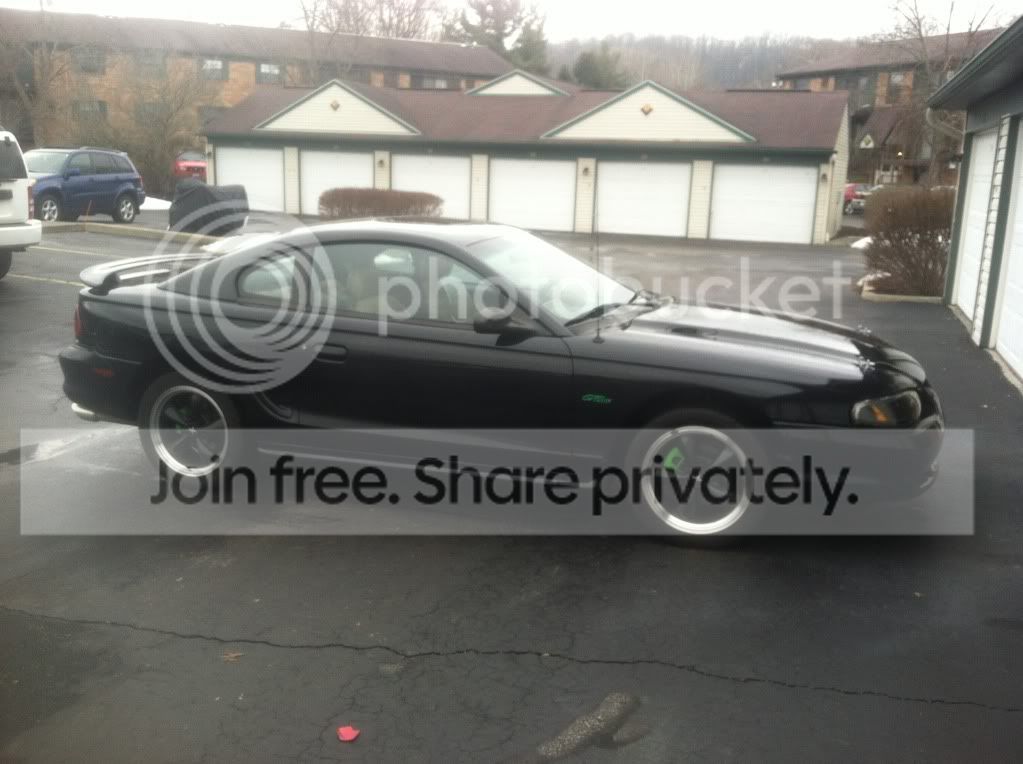

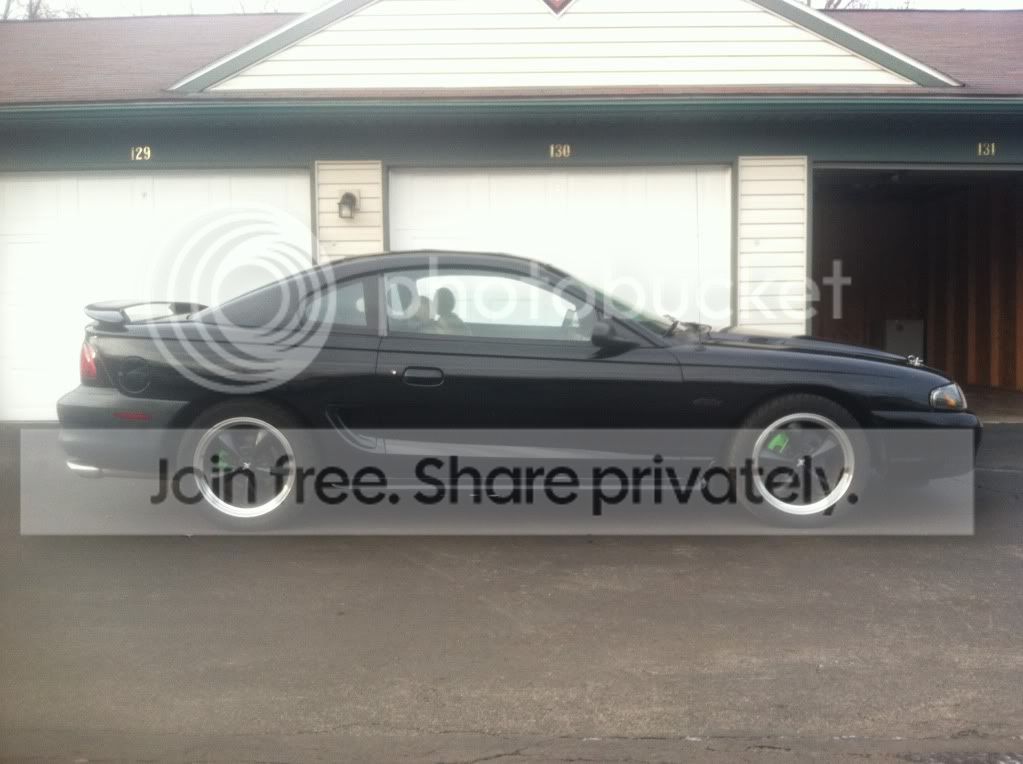

New guy here. Longtime Fox Body guy. Brought this beauty home yesterday. It's got either B or C Motorsport springs in it. I'm hoping they are the C springs with progressive rates.

Ford Racing B Springs, Tokico Blue HP Shocks/Struts, new isolators
