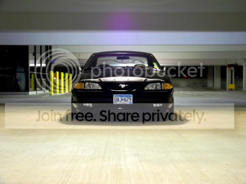

H&R SS springs all stock isos, Tokico blue shock and strut, bilsten quad shocks, J&M CC plates, Comp. Engineering bumpsteer, steeda x2 ball joints no shims

* Your car is beautiful, just amazing looking. - I just promised myself that your parts list is my template for the "new' Cobra I have. Part for part. Any comments now that the work is done? My last suspension job was put together exactly the same parts-wise, but with different manufacturers. PM me if you have any comments in regards to your build, please. Thanks, -Robb
Looks Great!!

I love the H&R ss springs, they ride great and with the tokicos they are nice and soft when cruising on the highway. A buddy of mine in his 96 gt had eibach and the shocks escape me on what he had but he had those along with steeda bumpsteer and mm cc plates. He rode in my car and loved it more than eibachs were pretty stiff for him. both of our cars sit at the same height. My car in the corners is just as good as his. Only thing i regret getting is the Competition engineering bumpsteer kit i have. You have to drill out the spindal where the tie rod end goes in. If i redo my suspension the only thing i would do is get the steeda bump steer and get new spindal sincemine are drilled out.
