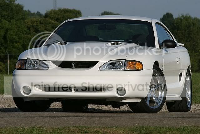

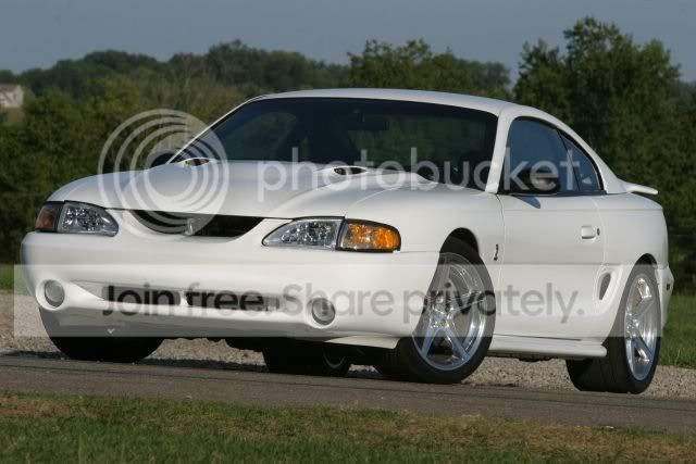

My 1994 Cobra (now nicknamed Ex-Terminator) started life as a bone stock cobra. It was later powered by a Vortech SC. Then i decided to switch to a single turbo. Before I could install it, i sold everything and started putting together the parts for a 408 with all big stuff and custom cam. This is where life changed. I found a good deal on basically a 04 cobra without the body.
A complete comversion started around Sept. 2007. It was completed around May 2008. A 5.0 magazine photo shoot was done at the NMRA Columbus event in Sept 2008. Look for the feature late summer early fall 2009.
Mods.
Engine
04 cobra motor
Stage V+ port
60 lb inj
SCT 2800 maf
2.76 upper and 4 lb lower pulley
4 piece idlers
Accufab TB and plenum
MAC longtubes
X pipe
Mac Flowpath catback
EGR delete
AFCO heat exchanger
self made cooling kit
Brakes
Hydroboost
04 cobra front brakes
94 cobra rear brakes
Suspension
94 front spindles
Saleen Springs
Billistein front struts
04 cobra front control arms
04 cobra front sway bar
PA racing Tubular K
FFR up0per/lower control arms
stock 94 cobra rear shocks
stock 94 cobra 8.8 housing
strange 31 spline axles
3.55 gears
carbon fiber clutch pack
04 cobra pinion flange
04 cobra alum driveshaft
T56
Spec alum flywheel
Spec stage 3+ clutch
Pro 5.0 base with MGW handle
Fuel
04 cobra fuel tank
Twin GT pumps
Fore top hat
Dual FPDM's
99+ filler neck
Interior
stock 94 cobra black cloth
04 cobra instrument cluster
04 cobra pedal assy
6 speed knob
04 cobra every piece of wiring in the car.
04 cobra door internals
04 cobra 6 disk stereo
Exterior
Stock 94 cobra
96-98 cobra hood
Build up
http://sn95forums.com/index.php?topic=23093.0

Very nice... Just a thought it would have been nice to see the interior and a shot from a rear angle because those are all the same.

are those the stock headlights? I want to get rid of the ugly stock gt lights, but i don't want the clear corners....btw, the car looks great, awesome stance too.....
wldtang
Mar 26, 2006
244
Re: *NEW* March 09 ROTM - wldtang
no. they are cobra replacements. I have the corner lights for sale in the pics above. I went to clear corner light.
