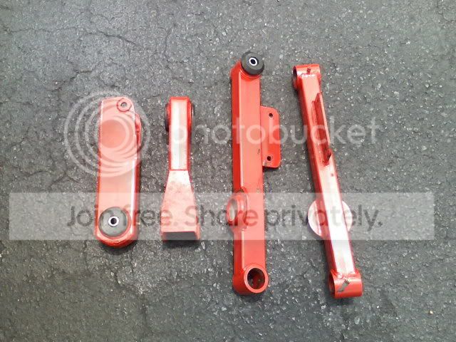

What does everyone think of MAC? i picked these up for $50 at mustang week, They were off of a wrecked 97 gt. i ordered new bushings for $56 should be here tomorrow. They look real solid and if the car was wrecked and their still fine i think that says somethin right?
heres a pic
-Pat
