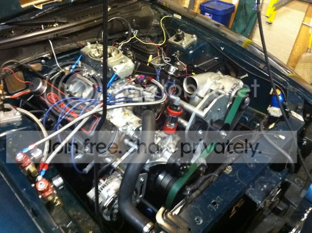

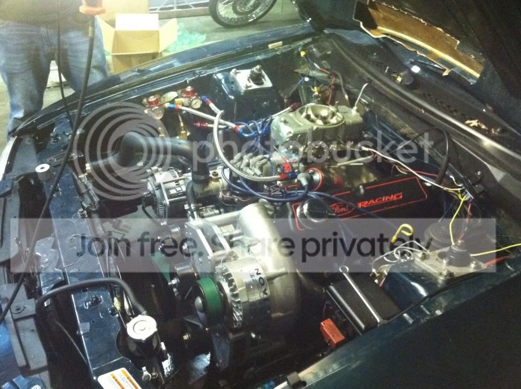

351W street car, in my 1996 Mustang GT. Car has been 10.40s@ 127 mph here at this altitude.
New goal, 9.50's at this altitude while still being able to street drive it. Car has a blower bolted on now. Just do not have a Blow through carb yet, or a fuel system to support it.
here is a start up video.
Novi 2000 efi renegade setup - YouTube
The rest of the parts to finish will be ordered tuesday, and hopefully some dyno time towards the end of this month. Healthy little street car!!

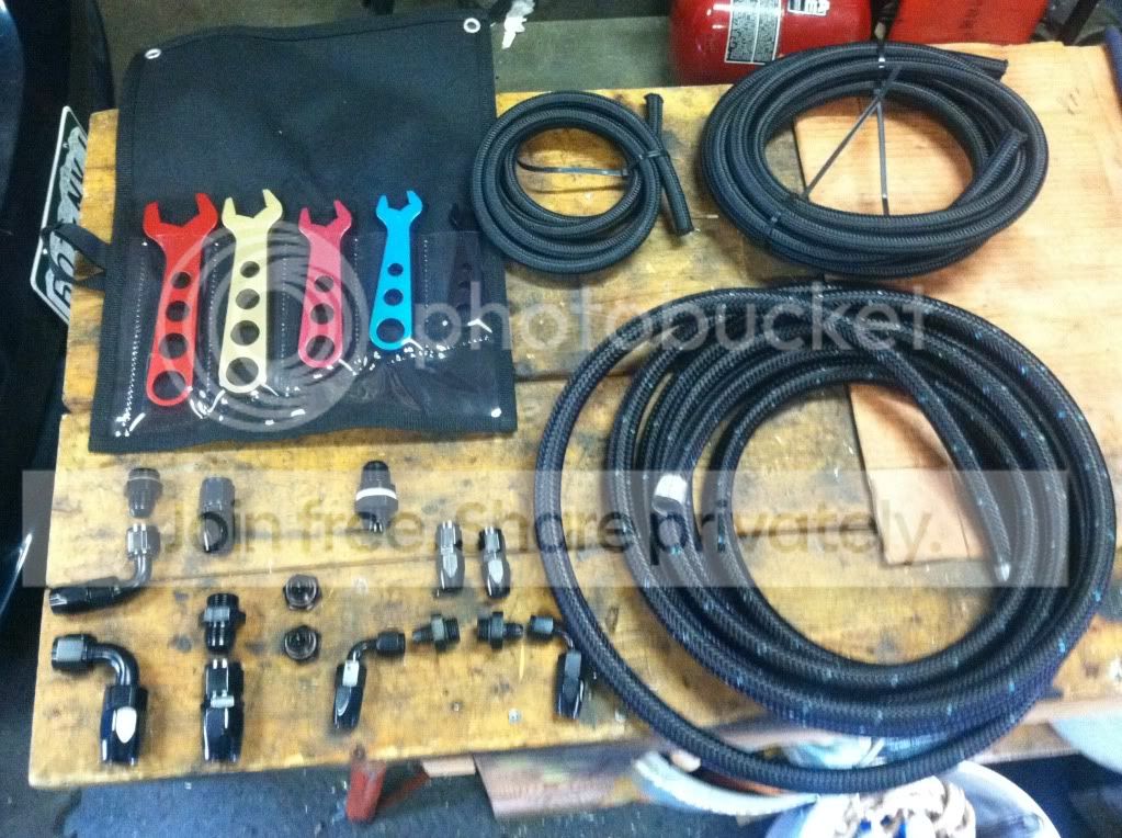

All the fuel parts have been ordered, other than the carb! Should be getting close!!! Also should NEVER have to put a new system in the car.
-8 Feed line, -10 Return line, Aeromotive boost reference regulator 13202, MagnaFuel 4303 pump ( 2000 hp EFI pump). I will get the pressure down from the pump using the bypass regulator...
Should be interesting!

Sure doesn't Look like the total I spent on these bad boys... But here is all the lines and fittings for the fuel system!

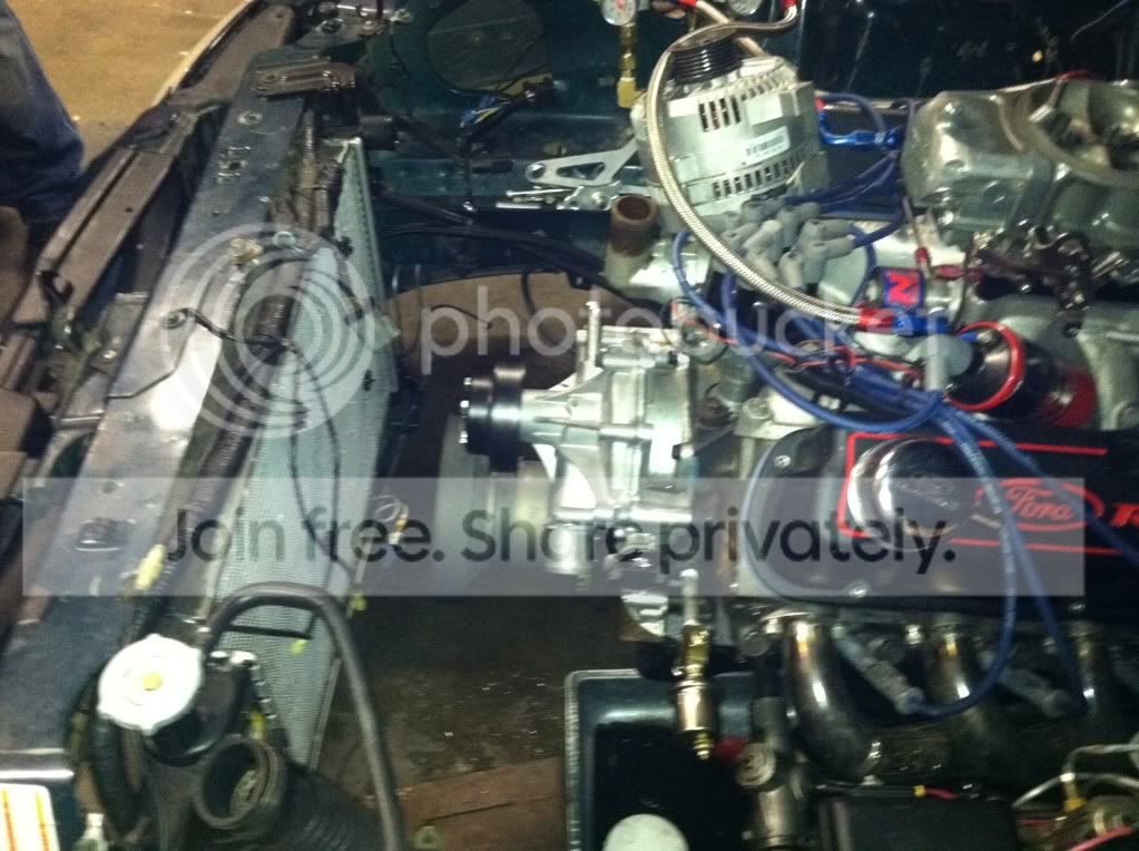

CSU carb was ordered today. Prolly take 2-3 weeks for that to show up though. Just a matter of waiting for all the parts to show up now. Everything but a datalogger and a Radiator Fan setup has been ordered.
The BeCool Radiator will be here tuesday. Procharger Red BOV might be here tomorrow. The carb hat and spacer has a possibility too.
I want the carb hat and the spacer here so I can cut my hood the way I need to to make it fit.

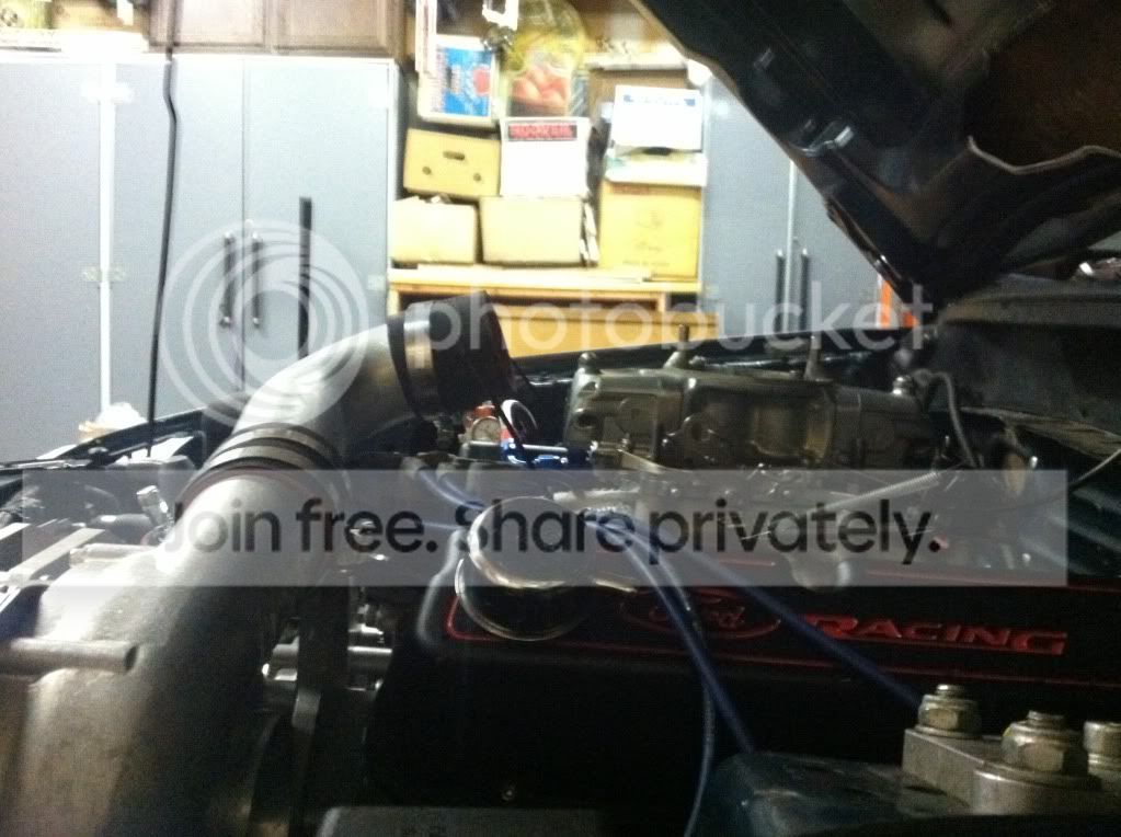

Boost gauge is in. The discharge piping is being welded as of right now at my buddy's house.
Just gotta wait for more parts to show up...
