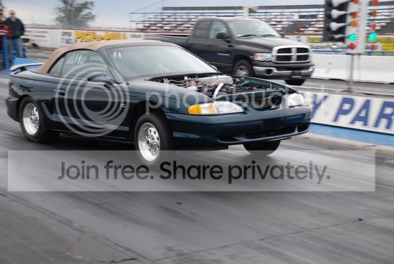

thanks for the comments. the picture is of an 11.0 pass. but it has run a new best of 10.96. not too much faster but im working on that. we just did the upr tubular front suspension and a moser 33 spline spooled rearend with a fresh motor so i'll keep you guys posted.

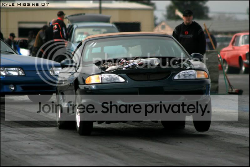

331, 200 shot, lentech aode, and sticky mickeys out back is pretty much the setup. its had interior stripped for the most part, and lakewood 90/10 up front, and 50/50 out back with moroso trick drag springs. it has a stallion 4200 stall and other misc stuff. it hooks a 1.54 60ft time off a foot brake wich isn't to bad. im hoping to better that time with the new upr tubular front end and the moser spooled rear end with the fresh motor and a pa transbrake. thanks for all the comments guys!!!
